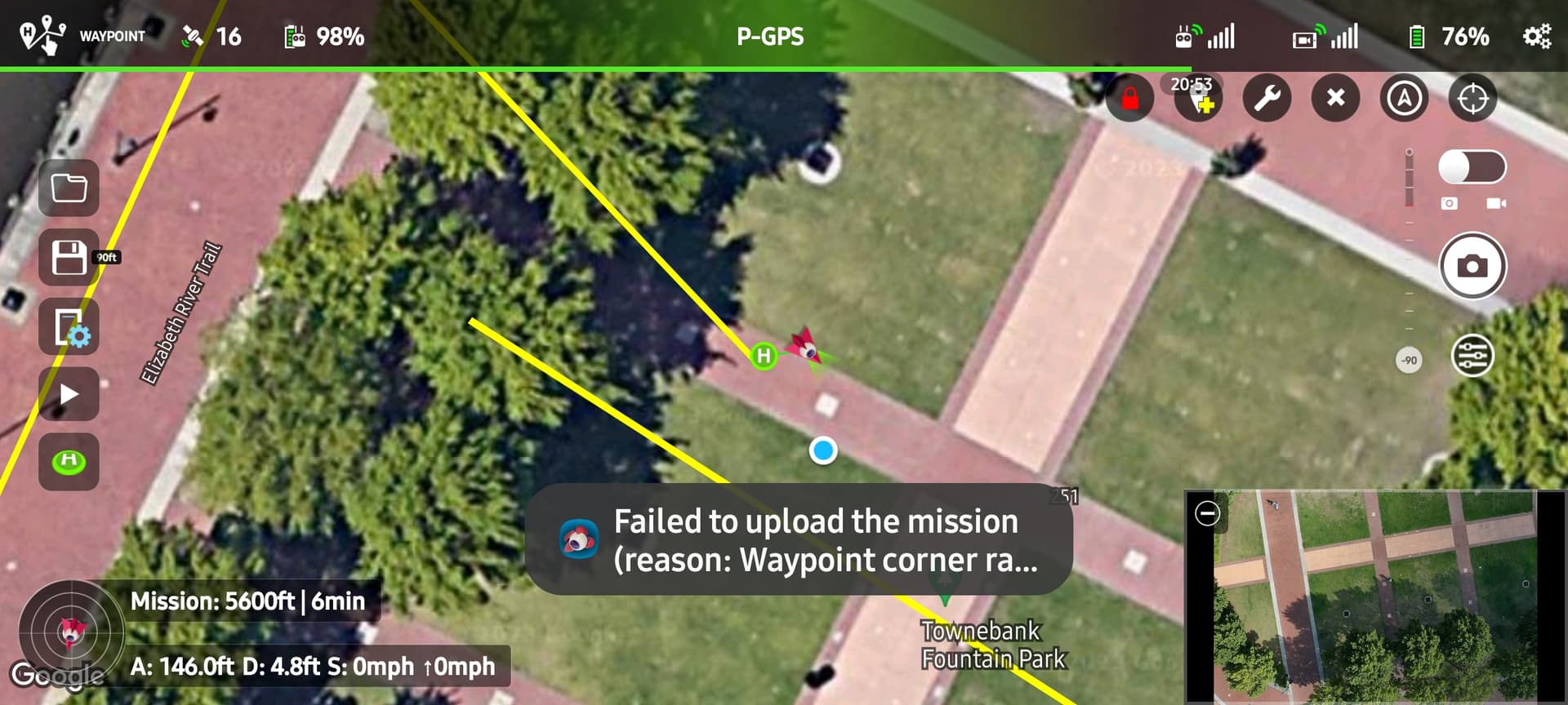

I was unable to load my mission to my mavic 2 pro. It gave an error on the screen but there was not enough room on the screen to see the reason why. Is there a log that I can open to see the message?
Take a screenshot of the portion of the error that is displayed and post it here. While there is a log that begins at power-up, it probably won’t show a mission loading failure.
Also. The distance from the first to the last point is less than 1,400 Feet.
The missing part of that error message is “Waypoint corner radius is out of range”. It is saying that one of your waypoints has a curve size that is outside of the allowed limits. The allowed limit is from 0.2 m to something large like 1000 m. Check he curve sizes in the Mission Hub.
