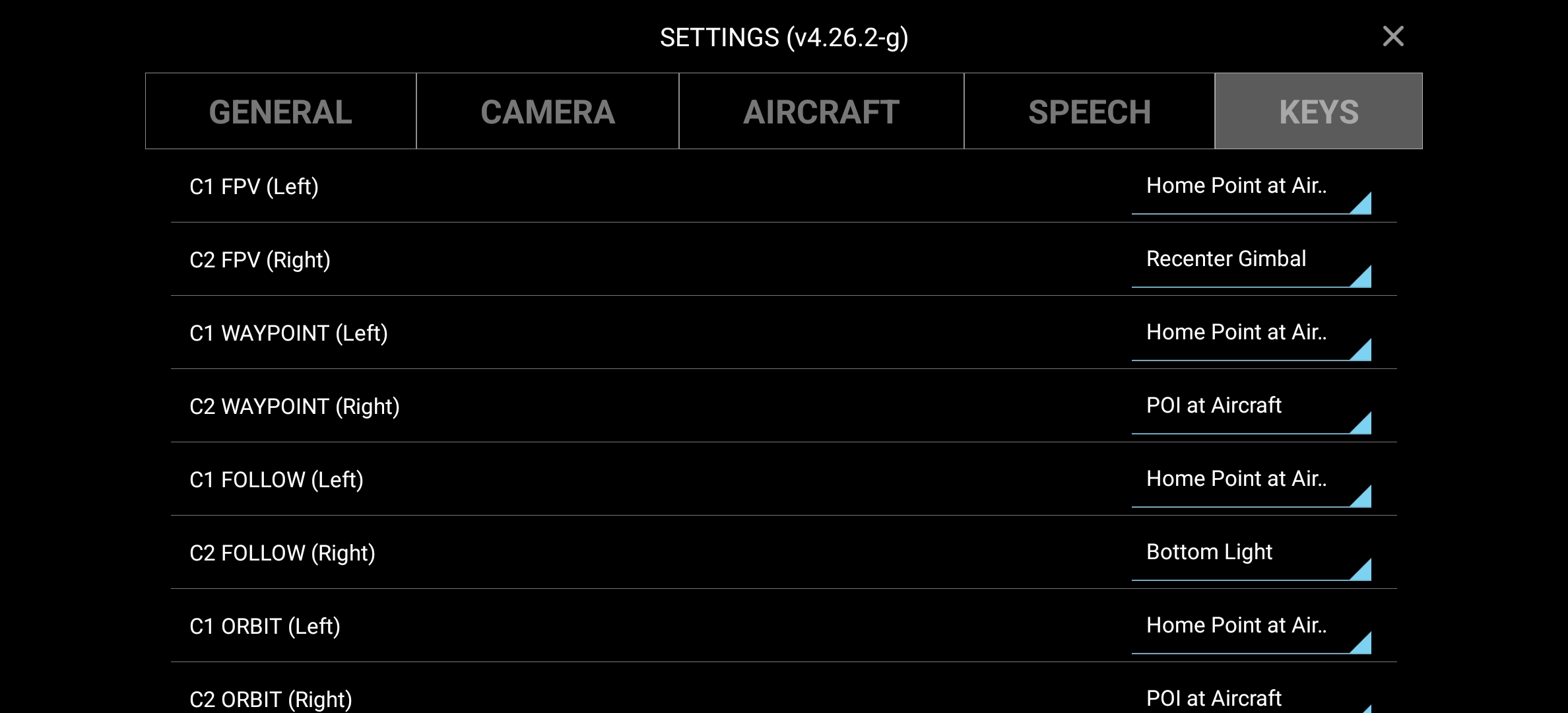

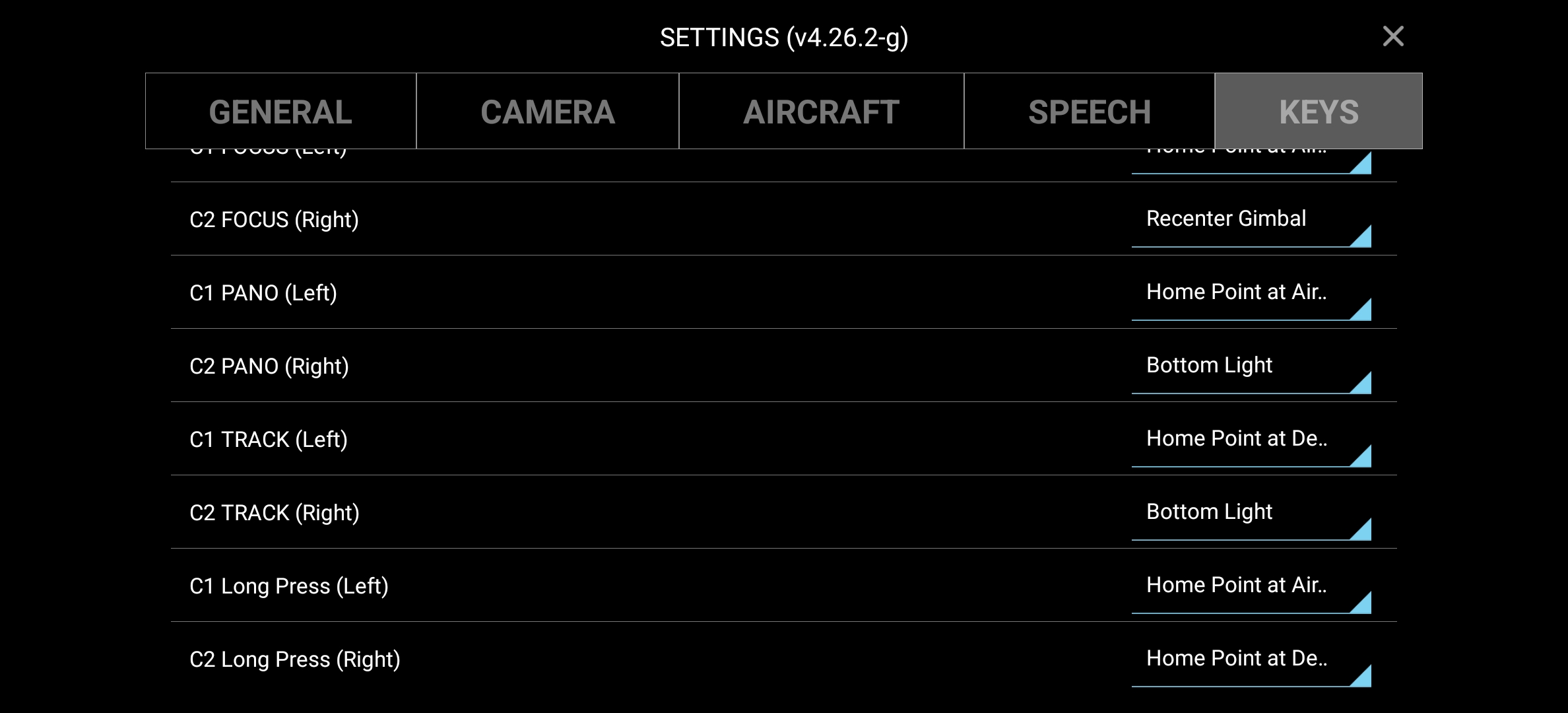

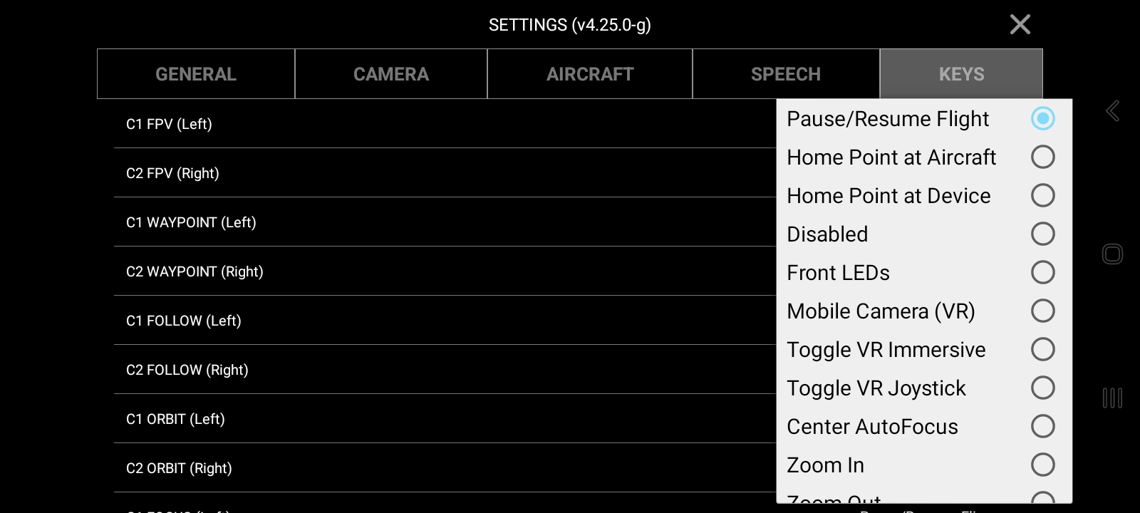

@Octavio Remember that there are several options available for each fn button choice by tapping the default option.
Yes, thank you. But some donât make sense to me, like the one âHome point at Aircraftâ I would presume it just means âLandâ or âHome point at Aircraft take-offâ!
Those choices would âresetâ the Home Point to either the Aircraftâs current location or the Controllerâs current location.
