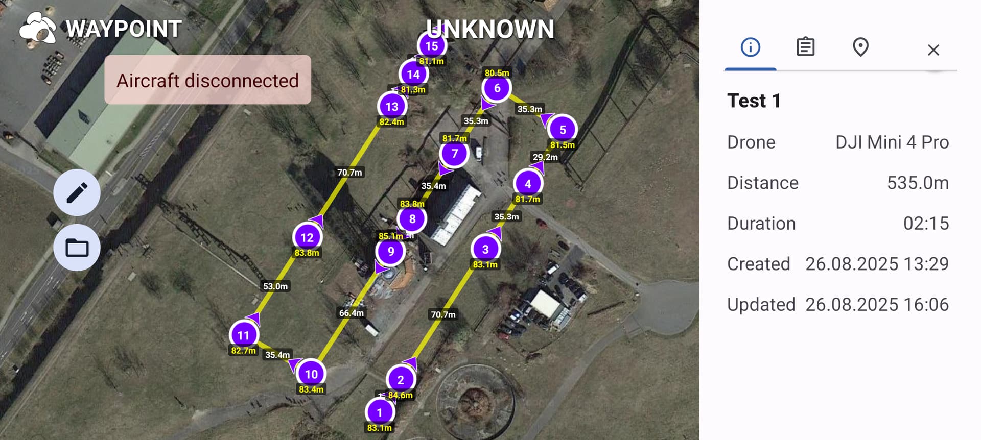

Is it really not possible to see the live picture during waypoint missions?
Why are the waypoints so strange positioned? Because of above terrain level? But if, why does it only slows down on those points and not all other 2 seconds during the picture is taken? See screenshot.
Any tasks?

It is possible that DJI Fly (in background memory) is interfering with Litchi PIlot. It is recommended to force-close DJI Fly when using Litchi Pilot.
You question is not completely clear but I think you are referring to the spacing created between waypoints of a mapping mission. If that is your question, it is because when using the “Above Ground” option, waypoints are only added to photo locations where the ground elevation deviates more than one meter from the previous photo location. Where the ground elevation is relatively level, “distance intervals” are used to capture photos. This is an automated feature in the new mapping function of the new Mission Hub. It helps to minimize mission flight time while capturing all of the required photos.
If that was not what you were asking, please provide more details.
The drone may slow to a stop at waypoints before capturing a photo. When using distance intervals, the drone will not stop as a photo is captured.
thanks for clarification. I force closed DJI Fly app, but will check again.
I underdstand that those waypoint are due to the “above ground” function. BUT: why is he slowing down only on those points and not on every photo taken? Or are those 2 seperate things? One for the elevation and the other is the automatic photo capturing every 2 seconds? But then: he will only slow down on some random “above Ground” calibartion points and not every 2 seconds?
Thanks
I thought I already answered that:
