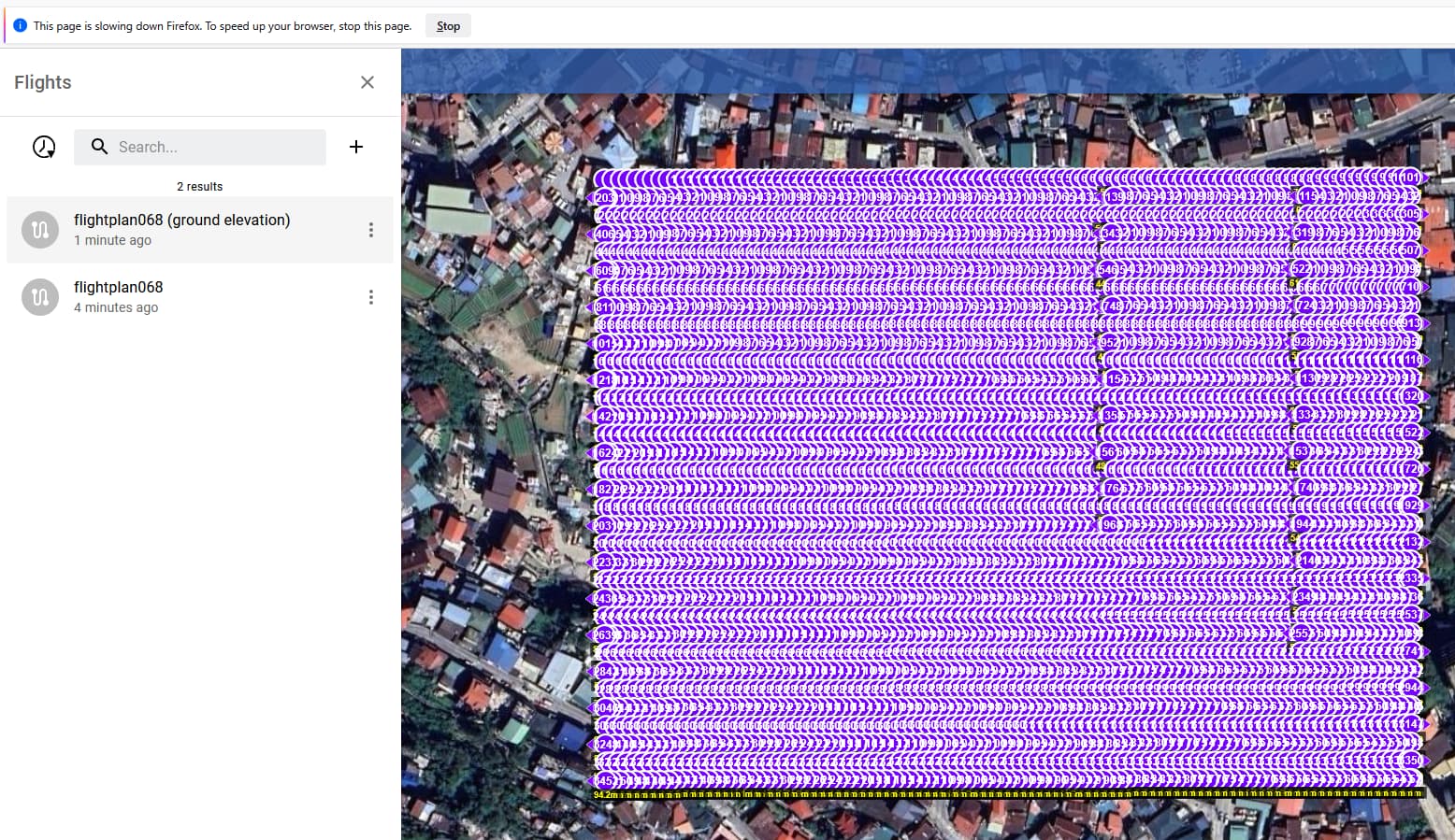

I get this message where it says: “This page is slowing down firefox” and at that point the page is non-responsive and I have to wait, sometimes up to 30 seconds or even a minute before I can continue.

That is a very large/dense mission. The quickest way to reduce the size of the mission and reduce the chance of getting that message from Firefox is to do one of the following:
  1. Increase the altitude
  2. Decrease the forward and side overlaps
  3. Break the mission into smaller pieces
I’m guessing you have several thousand waypoints. Is there something that requires you to have such a dense grid?

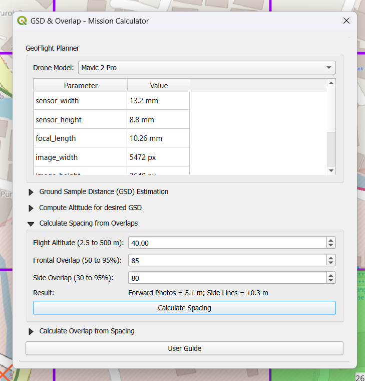

Would you share the type of drone (camera FOV), height you are flying at, and overlap percentages? I would like to run the numbers through my calculator.
Sure,
This is what I’m using the QGIS GeoFlight Planner
Which resulted in 10m and 5m at 40m altitude
Those calculations match mine. Unless you can reduce the front and side overlaps, the only thing left to do is break up the mission into smaller pieces. I’m assuming the type of terrain being mapped requires the overlap percentages you are using.
