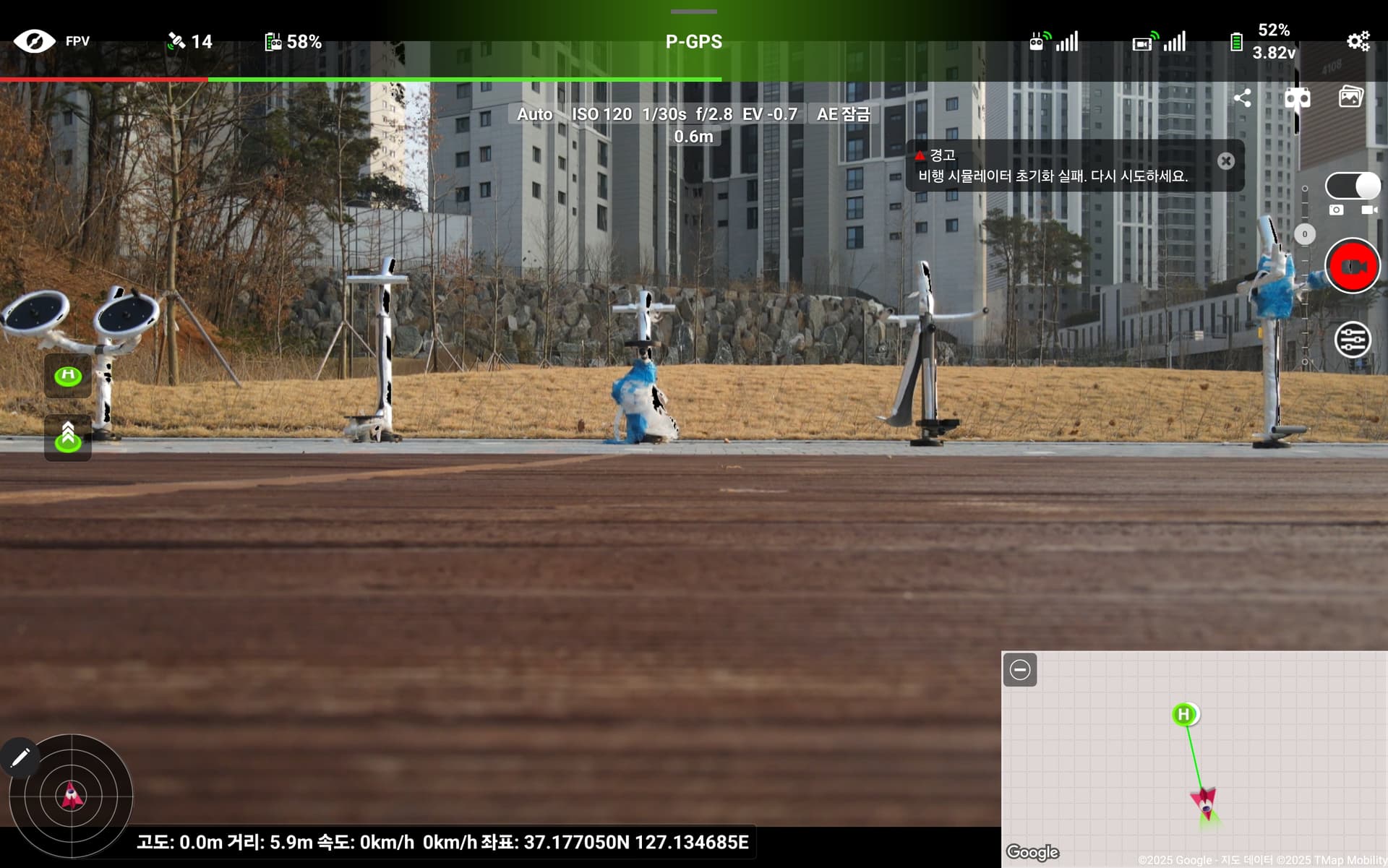

2.Then,next, I tried to connect litchi app to my tablet Samsung Galaxy Tab S9+ and as shown iin the screenshot below, I got message “Warning, Failed in initiallizing flight simulator. Try Again.” Could anyone help me fix this issue?
FYI, I am using Mavic Air2.
Your screen shot appears to show the Litchi app connected to your controller. What happens when you try to fly the drone?
1.With the warning message, Litchi app didn’t work.
I reinstalled the Litchi app again on the tablet and the warning message disappeared fortunately!
