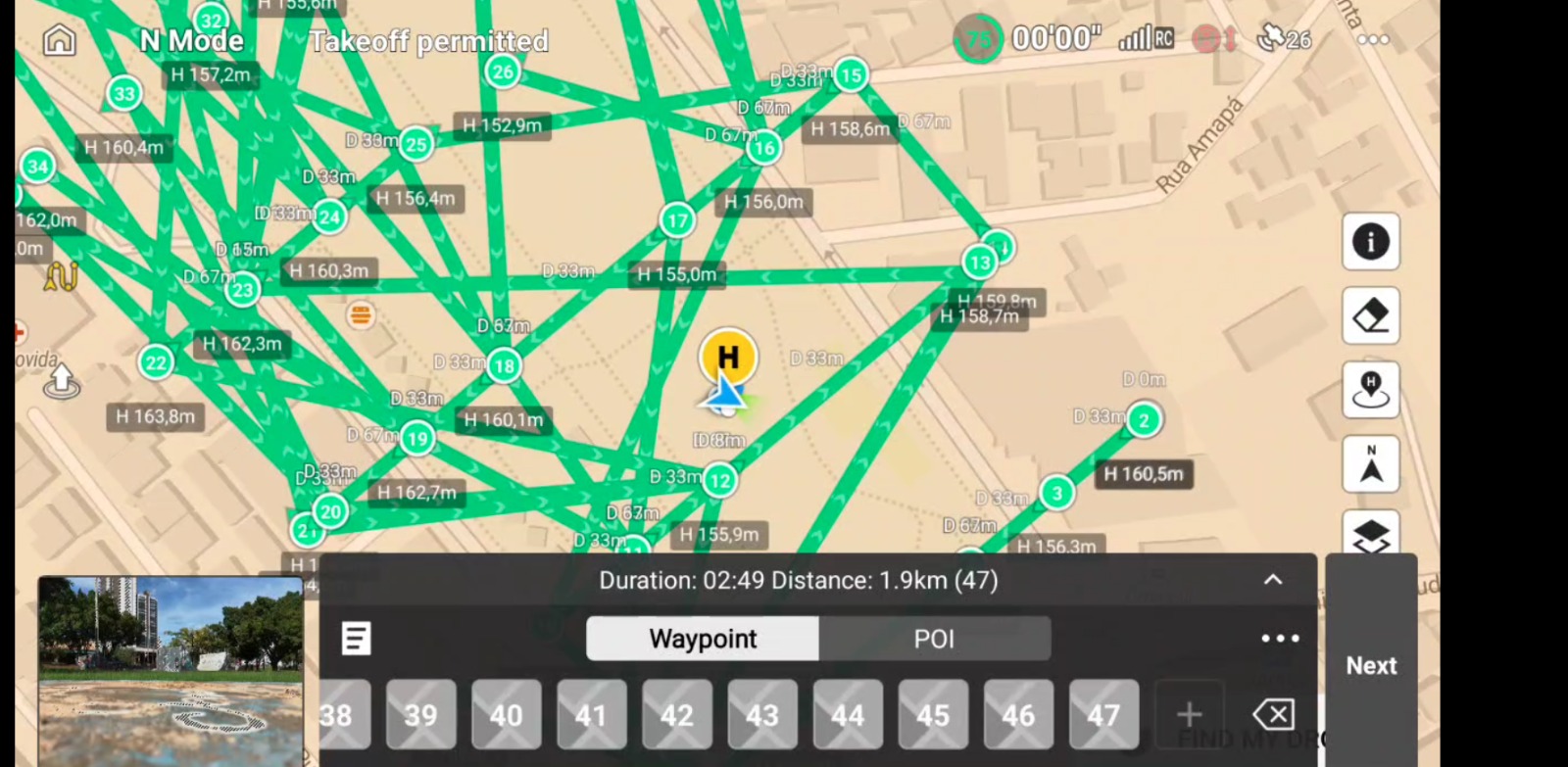

When creating a flight plan and exporting it to DJI Fly, an issue occurs depending on the selected Path Mode.
If the Path Mode is set to “Straight”, the exported flight plan contains multiple errors in DJI Fly and does not behave as expected.
The export only works correctly when the Path Mode is set to “Smooth Curves.”

I have seen this reported by others. However, from what I’ve read, only the display of the mission is affected. The mission itself executes properly. When you say “multiple errors” are you referring to the display of the mission or actual error messages?
I have flown a lot of straight line missions using a Mini 5 Pro. In my flights, I have not experienced this behavior. Without being able to reproduce it, it is difficult to know exactly what causes it.

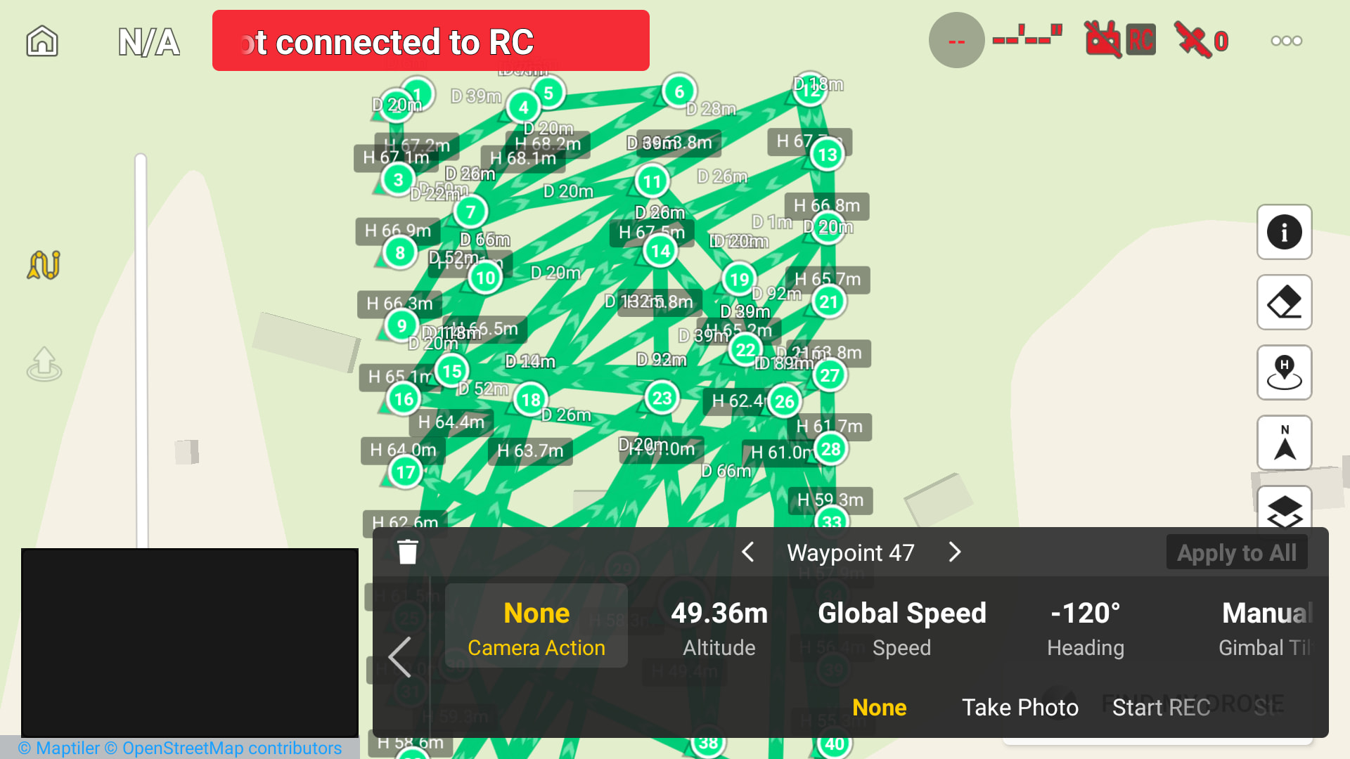

I’m having the same issue. A straight line mission is producing waypoints all over the place. I haven’t tried flying this yet but it doesn’t look promising. I’ve attached a screenshot from the controller and my hub setup and mission map area.
Path mode: Straight
Heading mode: Follow Path
Gimbal Pitch Mode: Manual
Photo Capture Mode: Interval
Please share the Litchi flight so we can take a look: [GUIDE] How to Share a Flight or Folder
So these actually flew as shown on Litchi Hub, however, the number of waypoints led to several stalls. My second mission over the same area using a different grid direction stalled out so bad I had to abort. Is there a way to reduce the number of waypoints in a mission? Ideally I don’t want/need all the waypoints between directional changes on straight leg grids for mapping.
