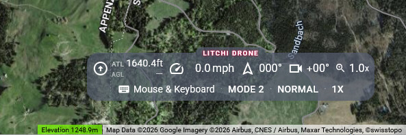

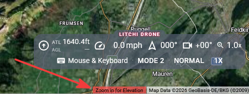

It may appear that elevation data is missing when you are zoomed out too far. When navigating to a “new” area, the Litchi Hub may indicate that there is no elevation data. However, if you’ll notice at the bottom of the screen, it will instruct you to zoom in to obtain elevation data as shown below:
Once you zoom in sufficiently, the Mission Hub will make an elevation query and load the elevation data for that area.
