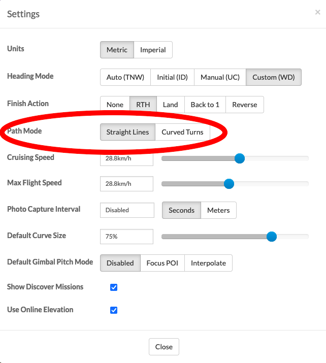

I’m trying to get my drone to hover at each of several waypoints for 10 seconds. I create a mission with the waypoints and then set “Stay for” and enter ten seconds into the field for each waypoint.
However, the drone will only hover for ten seconds at the first waypoint. After that, the drone will just fly right through all the intermediate waypoints until it reaches the last one, and then it will just sit there until I take another action.

I was able to resolve the issue. I needed to choose “Path Mode: Straight Lines” (see image). Then the drone hovered at each waypoint.

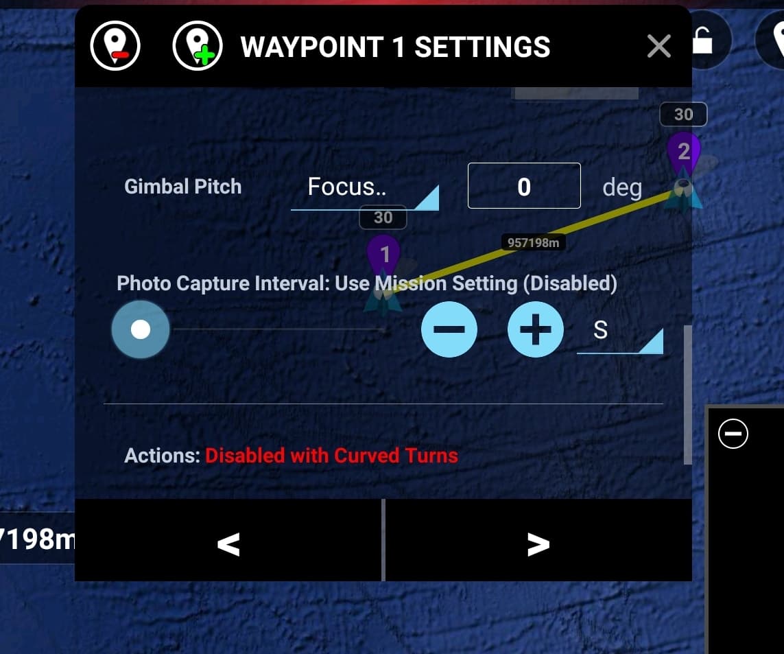

Have you seen the message in red?:wink:
I don’t see that warning message on either the mission hub website or on my iPhone app. Maybe it only appears in the Android version of the app.
It is not a fault with the Litchi app.
On a curved turn, there is not an actual point to put the
stay for command.
The curved turns that are inserted makes the straight lines
into a continuous line.
If you want to use commands, you need straight lines which
have a defined end where you can attach commands.
