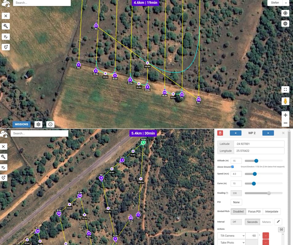

This AGL feature is useless! Lost my drone and sensor to a tree.
in pictures below you see the same area with two different flight missions the one set to 25m and the second 15m, in the first the height keeps going above 25m but in the other the heights go below 10 even.
I dont understand why the hieghts are relative to the take off point if your are using online elevation data, each point should be considered and calculated individually.
When I flew the grid at 25m my data was a mess because of the varying heights
and in the second grid I was sure the drone would clear the trees not noticing the heights dipping as low as 8m!

I understand and have read this help section over and over but still dont understand what to do to get the drone to maintain consistent ground clearance for obstacle avoidance and my data quality.
I assumed that it adds the flight height to the online elevation data but why in the second example is it flying lower.
The displayed altitudes are relative to the Home Point after ground elevation compensation. Meaning the grond elevation at the WP with 8m is 15-8=7m below the Home Point and the drone still flies 15m above the ground.
Also, when the ground elevation of the Home Point differs from the ground elevation at WP1, your whole mission will differ with the same amount.
Your Home Point and WP1 should always be at the same ground elevation.

In the Mission Hub, the height of each waypoint is calculated using elevation data. Then the waypoints heights are offset by the difference between the ground elevation at waypoint 1 and the ground elevation under every other waypoint. The drone can only ever calculate its height relative to the take-off location. The drone cannot measure its height above ground. So, it must depend on the heights calculated in the Missoin Hub and it assumes that the ground elevation at the take-off location is the same as the ground elevation under waypoint 1.
TriBar has already provided good details. Another thing to keep in mind is that the mission heights are only calculated at the location of the waypoints. Your first image shows some mission paths that may traverse over ground of varying heights. If the ground has many variations, you may need to add more waypoints to ensure the drone maintains the desired height above ground throughout the mission.
