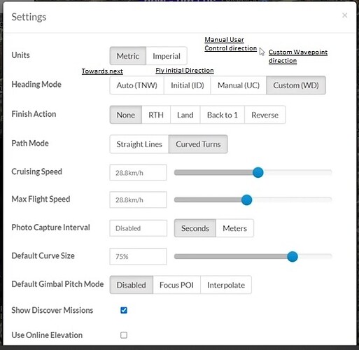

More than likely, you have your Mission Settings - Heading Mode set to Custom (WD).
This will cause your drone to slowly rotate toward the heading of the next waypoint.
If you want your drone to just fly straight along the path and not rotate, set it to Auto (TNW) which is âToward Next Waypointâ
Check your settings and let us know what you find.

In the settings:
