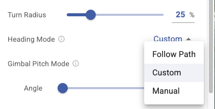

You can adjust the heading mode in the mapping settings:
Advanced - Heading Mode - set to Follow Path

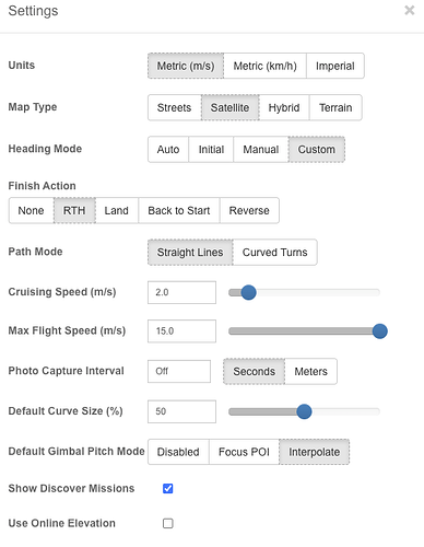

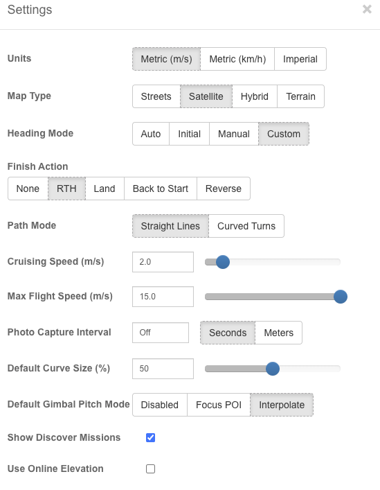

I don’t see that option
You need to be using the new Mission Hub. Your screenshot is of the old Mission Hub. Or, if it was the old hub you were using, set the heading mode to auto.
