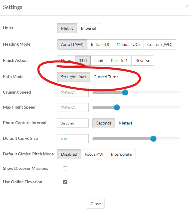

In Mission Settings, the path mode needs to be set to Straight Lines, otherwise it will ignore the actions.

I actually heard that you can’t use curves and since I did want curves in the video, I set only the waypoints where there were actions to 0-curve. But I guess that’s not good enough sinceb only doing it on mission settings works!
That’s not good enough, the mission needs to be set to no curves at all. I’m trying to find a workaround currently like I have already with Litchi Surveys.
You can just complete the mission twice. And put curve lines for the video
That’s how you can do it! A lot of people don’t seem to know about this. You need to add two wp… at each point where you want to perform an action. To do this, you need to set the coordinates on the keyboard to the same as the waypoint. But make the height 1 meters more, and then 1 meters less. Thus, the drone will accurately stop at the waypoint and perform actions.
Good luck on your mission. :slightly_smiling_face:

Straight line mode only
