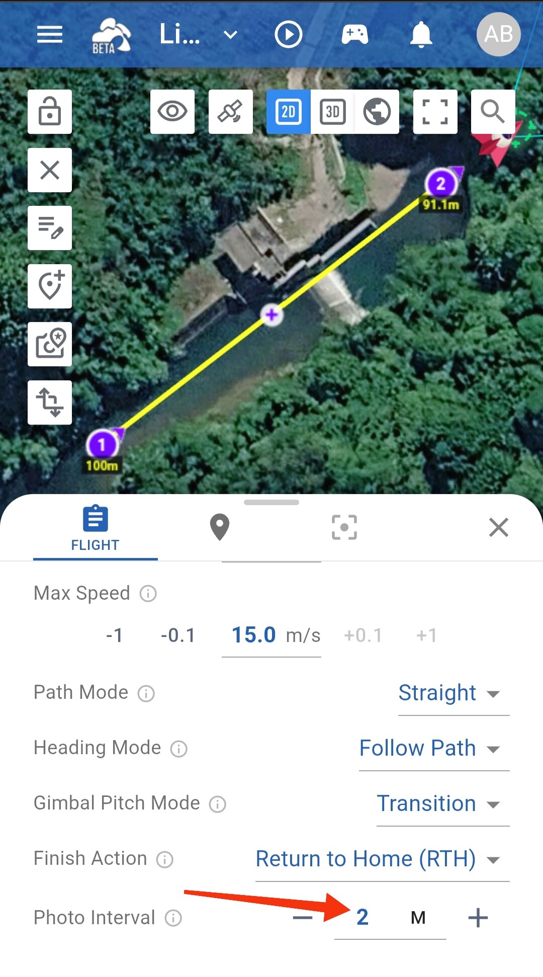

How do I configure the DJI Mini 5 Pro via Litchi Hub to capture photos at intervals of XX meters similar to the settings available on the DJI Mini 3 Pro? Alternatively, is there another method to achieve a comparable result? I plan to conduct a mapping survey of a long river.
This is what shows when I choose DJI mini 3 pro:

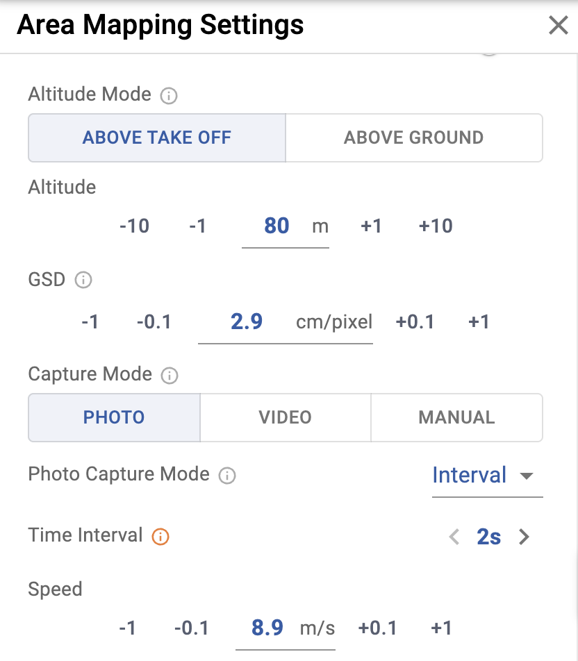

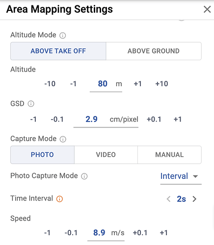

Litchi Hub now lets you select the photo time interval you wish to use and automatically calculates the speed. Or if you prefer, set your speed and the interval is automatically selected for you. No need for any manual conversion, just need to remember to start the interval capture manually when the flight starts as we can’t program it in for DJI Fly.
