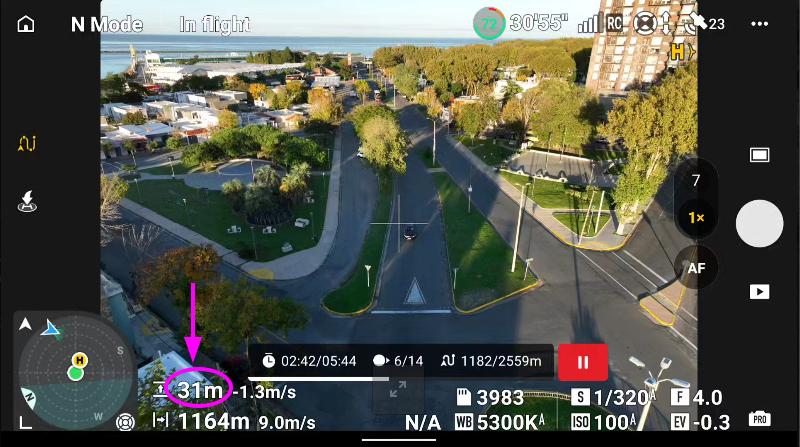

  1. At a certain point during the mission, the drone began to descend, and when it dropped to 29m, I suspended the mission.

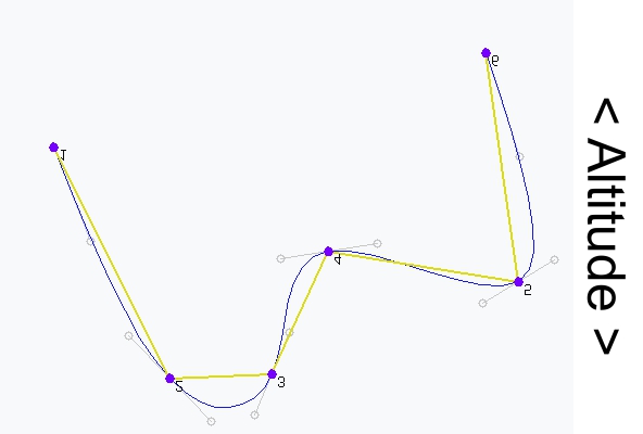

It’s the result of the way a path with smooth curves is created in DJI Fly. The flight path can, depending on the 3D position of neighboring waypoints, descent below the height of the waypoint with the lowest altitude, and vice versa.

  1. If the descent from one waypoint to another were from 50 m to 10 m, I understand that, due to the Bézier curve, Fly’s altitude would be 0 or even negative at some point.
That is not the case, as I have pointed out; all are between approximately 50 and 60 m.

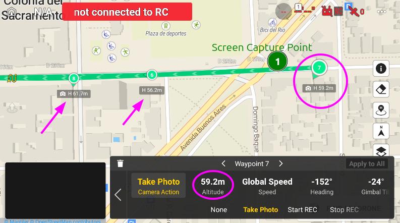

In Fly
WP6 H=56.2 m
WP7 H=59.2m
WP8 H=61.7m
It doesn’t make sense to descend that low, even if the distance between waypoints is somewhat “long.”
You can see this in the screenshot posted on the DJI forum I mentioned.
  1. How altitude is measured isn’t relevant here.
The hub displays terrain altitudes (ASL). Therefore, 50m “Above Ground” altitude in the hub becomes 59m “Above Takeoff” (for example) in DJI Fly (and this is how the hub displays it at each WP).
That’s fine, but during the flight, Fly showed me 50m even though the WP was marked as 59m.
The 59m above takeoff setting was not followed.

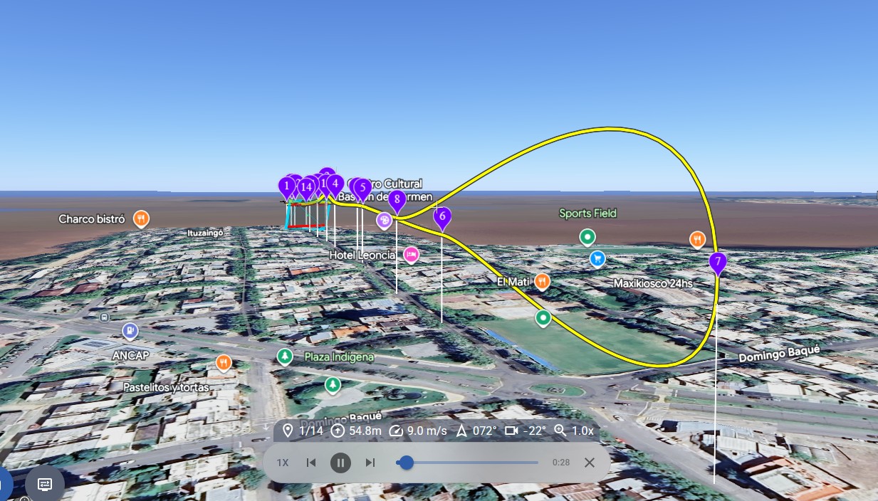

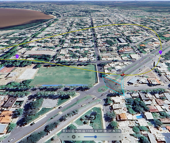

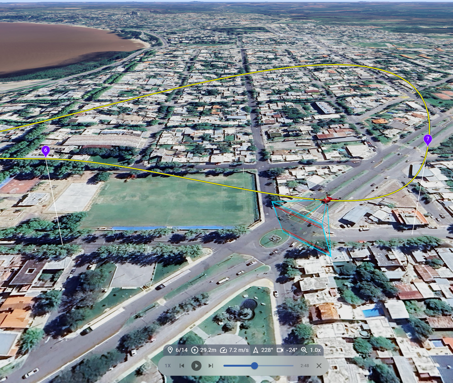

The google earth view does show pretty clearly what will happen in real life, including when it descends to 29m.
Vico is correct. I was concentrating on the beginning of the mission. However, around waypoint 7 is the main problem:

  1. The first segment, in which only video is recorded. The altitude remains constant at 50 m even though the waypoints have different altitudes defined. There is an interruption when the signal is lost.

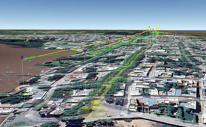

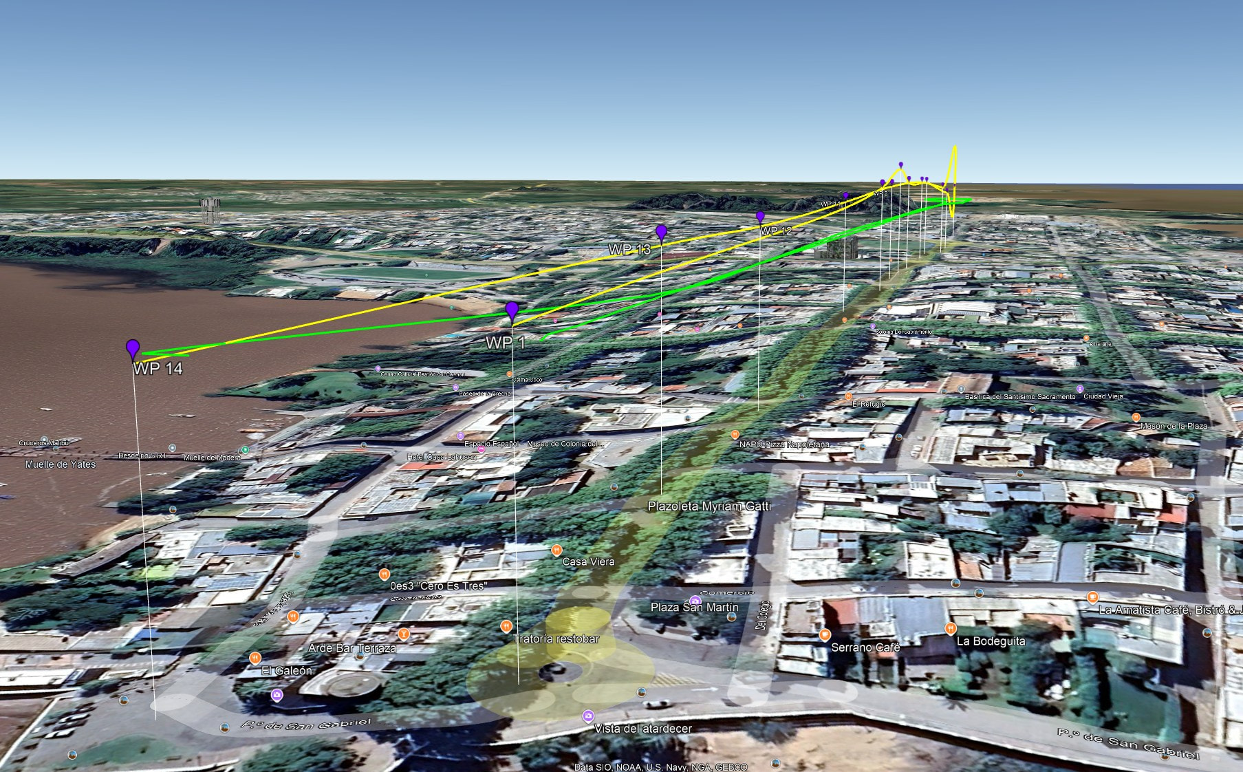

The two waypoint sections will be of interest. Here is a 3D view of the first waypoint section (green) and the Litchi mission (yellow) you shared.
Notice the Litchi mission (yellow) shows one waypoint (#3) higher than the others. Notice the actual flight (green) is flown at a constant height of 50m. This is confirmed in the flight data and your video. This suggests that the first waypoint section came from a mission where the height was set to “Above take-off” and the heights of all waypoints was set to 50m.

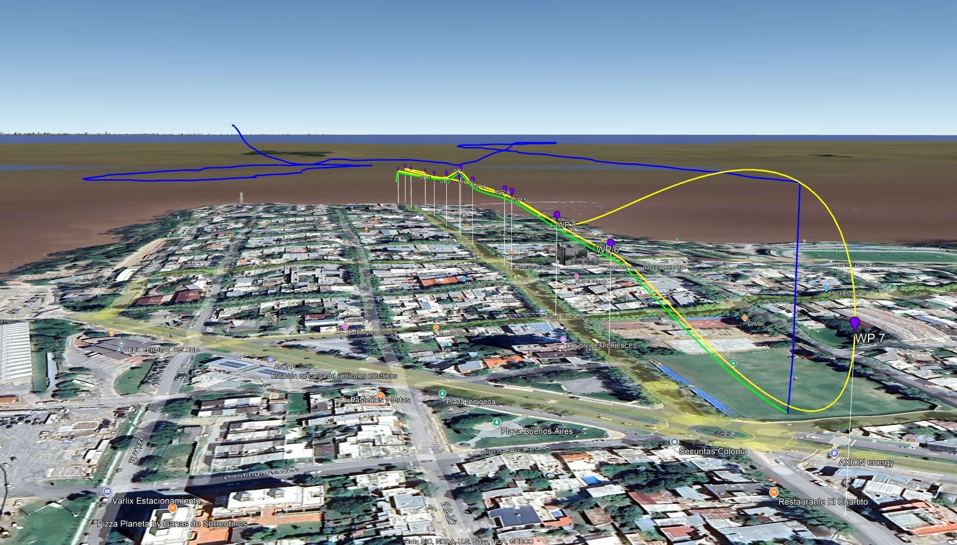

The second waypoint section in this flight data (green) closely matches that of the Litchi mission (yellow) you shared. Waypoint mode was exited when the drone reached its lowest point at which time you flew in P-GPS (bypass mode) (blue) straight up and then back towards the home point.
This flight path matches your Litchi mission and confirms the problem near waypoint 7 where the path must travel lower (and then higher) than waypoint 7 in order to create a smooth turn at that waypoint.
My conclusion is that your posts refer to two different flights. The first flight had the “Altitude Mode” set to “Above Take-off” and 50m heights at every waypoint. The second flight has a problematic sequence of waypoints (near #7) that causes the flight path to become too low.

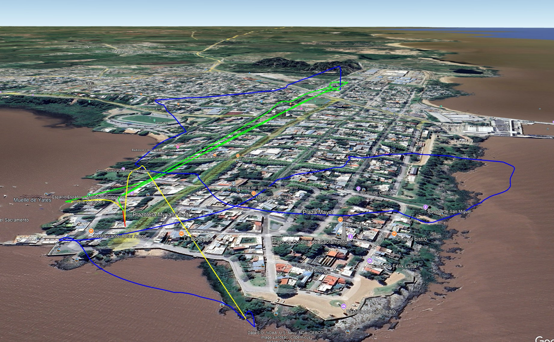

In case you are interested, here is the entirety of your flight in 3D:
  • Green = waypoint mode
  • Blue = manual (P-GPS) mode
  • Yellow = Go Home
  • Red = Landing
