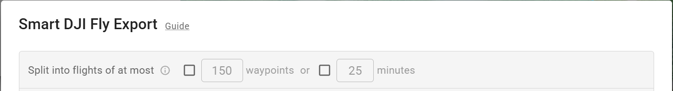

The RC Pro 2 controller has significantly more processing power than the RC2 and can run significantly more waypoints per flight than the known 150-200 limitation of DJI Fly app on the RC2.
Thus my limitation is in flight time per battery so it would be hugely helpful to be able to custom select the number of waypoints for each flight when you split a mission, and even more so be able to determine how the overall flight is split up. For instance, in between each full pass in a multi-pass 3D scan flight with oblique passes.
Thanks for all the hard work in getting this platform where it is!
We’ve made it possible now to split by both waypoint count and flight time
