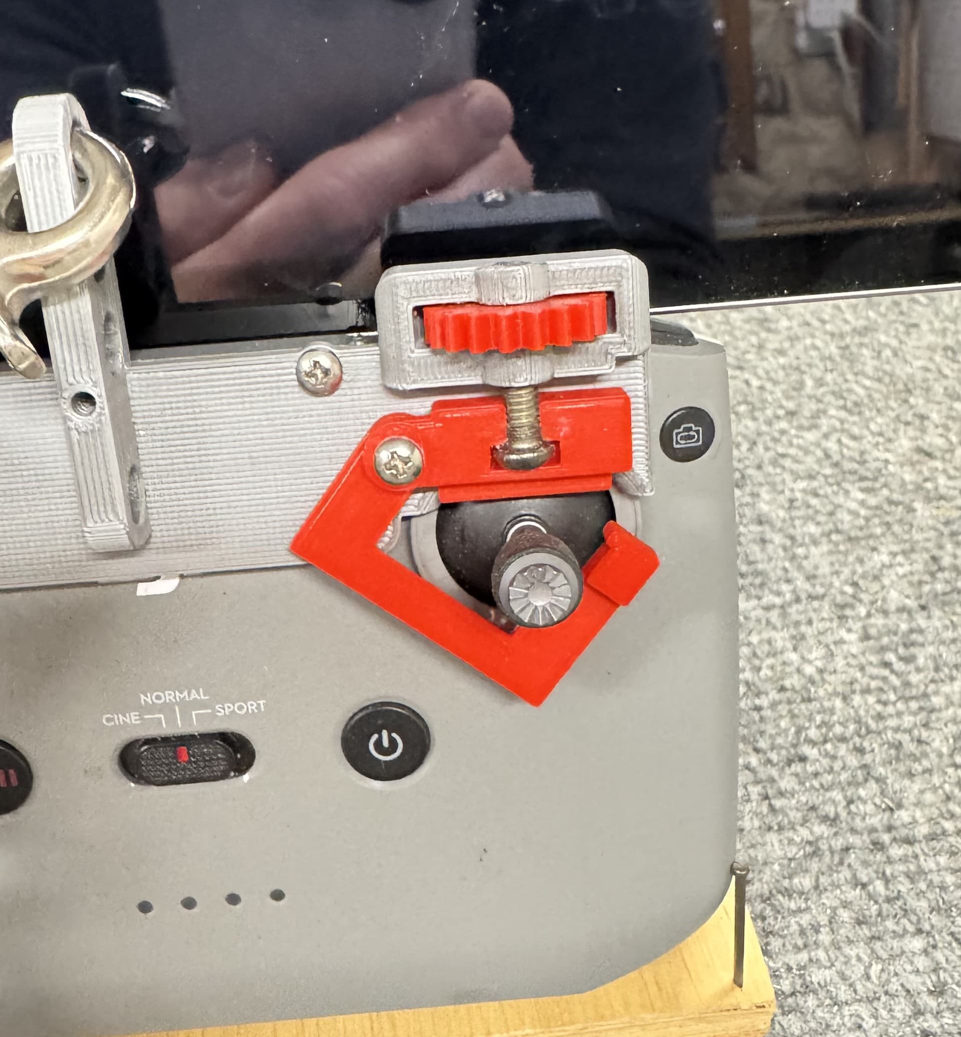

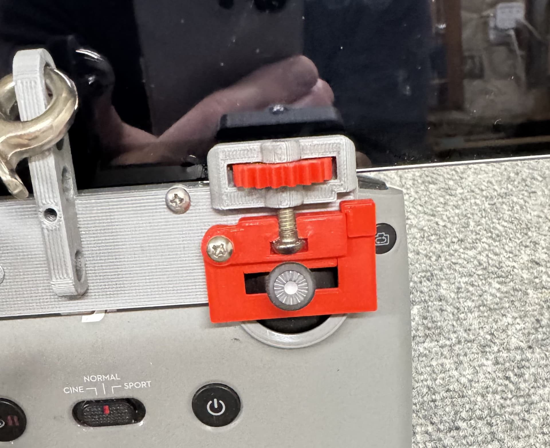

Here’s a gadget I designed and 3d printed to at least set a constant speed for my Mini 2. Flick of the thumb closes the gate, flick of the finger top right opens it. The gear wheel above allows speed adjustment. Slot allows normal left/right commands.
Brilliant idea that.
