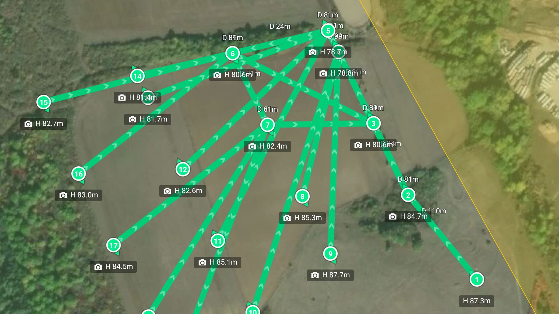

Hi everyone. I’ve tried inserting several missions and have noticed that, for some missions with a significant number of points (actually, they don’t seem like many points to me), around 60, the route in the DJI Fly app goes crazy. A crazy mesh is created where the route doesn’t follow the specified pattern.
I’ve tried missions with fewer points and they seem to be correct.
I’ve attached an image of this.
Do you know why this happens and if there’s a solution?
Thaks¡¡

There have been reports of this occurring when importing a mission with straight lines. Does your mission have straight lines or curved turns? Even when DJI Fly displays the mission incorrectly, when flown, the mission is executed properly.
There was no image attached. Here is an example of a “crazy” mission when using straight lines.
Hello! Yes, I can see I didn’t attach the image, but it’s like the one you show.
The mission had straight lines. The smoothed curves wouldn’t allow me to export them (yet).
I had the opportunity this weekend to test the route, and it did indeed execute correctly.
