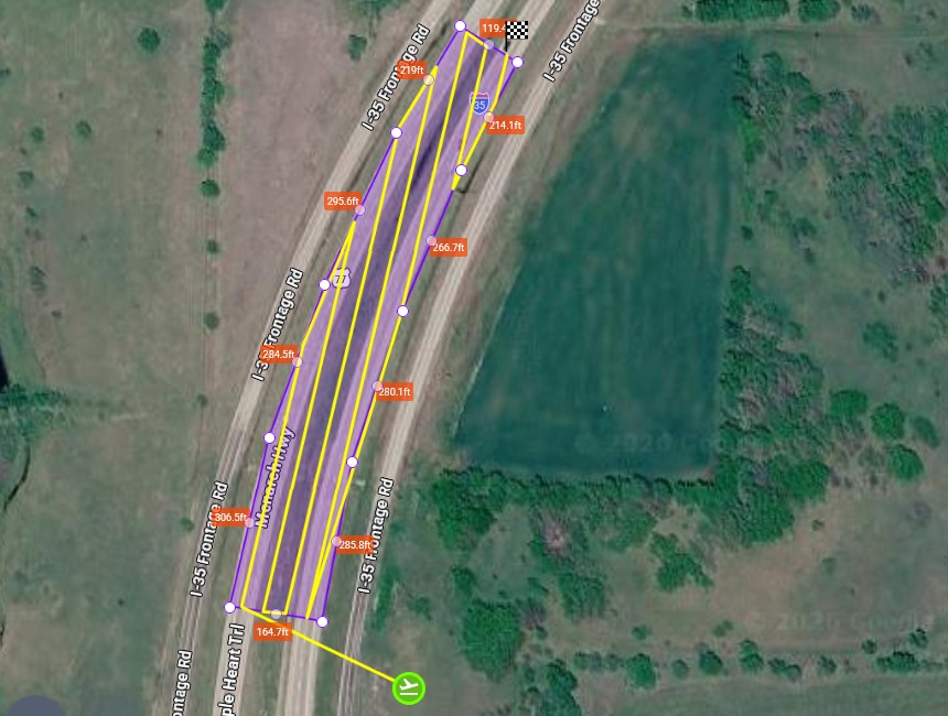

Check out Litchi Utilities by @wesbarris Corridor Mapping Mission Creator

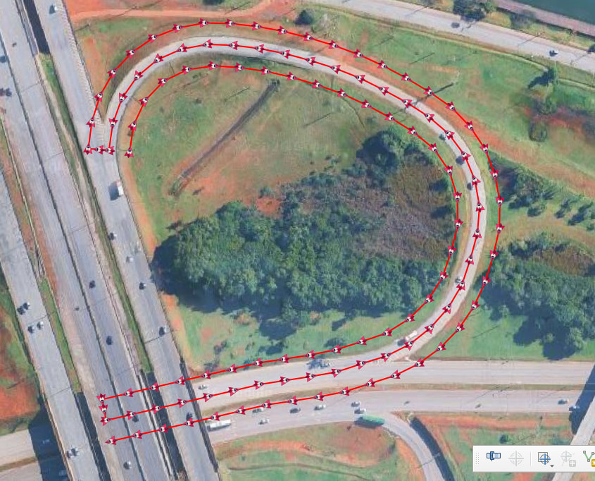

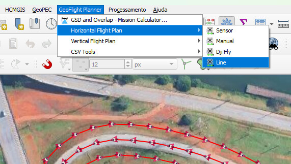

Plugin “Geoflight Planner” in QGIS solve this question. You choose space, lines number , … In menu, chose “horizontal flight plan”, and “line”. After you export csv to litchi…
Thanks @wesbarris for your reply. It works, but there are two issues:
1- As shown in the screenshot, the straight flight path leads to more time due to excessive turns.
2- For long corridors, the mission must be manually split to remain manageable and within the battery’s capacity.
