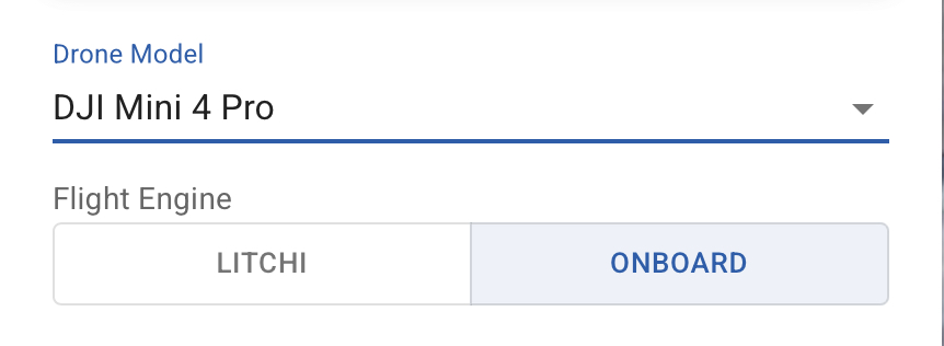

Is the “Flight engine” set to “Litchi” or “Onboard”?
I order to continue a mission after signal loss, “Onboard” waypoints must be used.
Thanks for the info. That may be the probblem.
Best regards!
