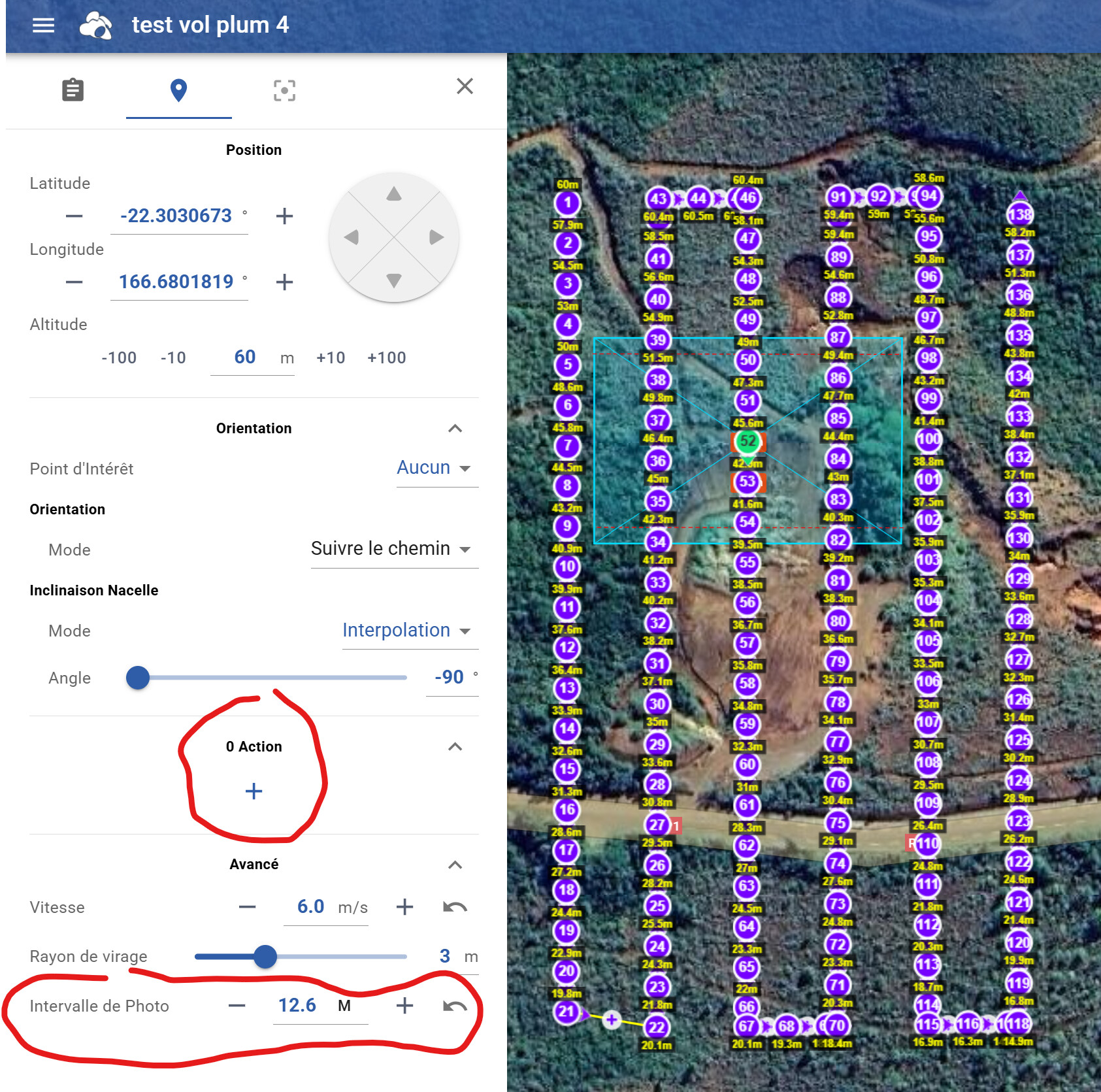

I performed a mapping flight, orthomosaic, with terrain following and a waypoint at each altitude change. However, the drone continuously stops at each waypoint to take a photo without having programmed a pause time. This significantly reduces the flight time for mapping the area.
Question: Is it possible to perform this flight by disabling all photo-taking actions at each waypoint, and then specifying the interval in time or distance for taking photos, without the drone slowing down and stopping at each waypoint?

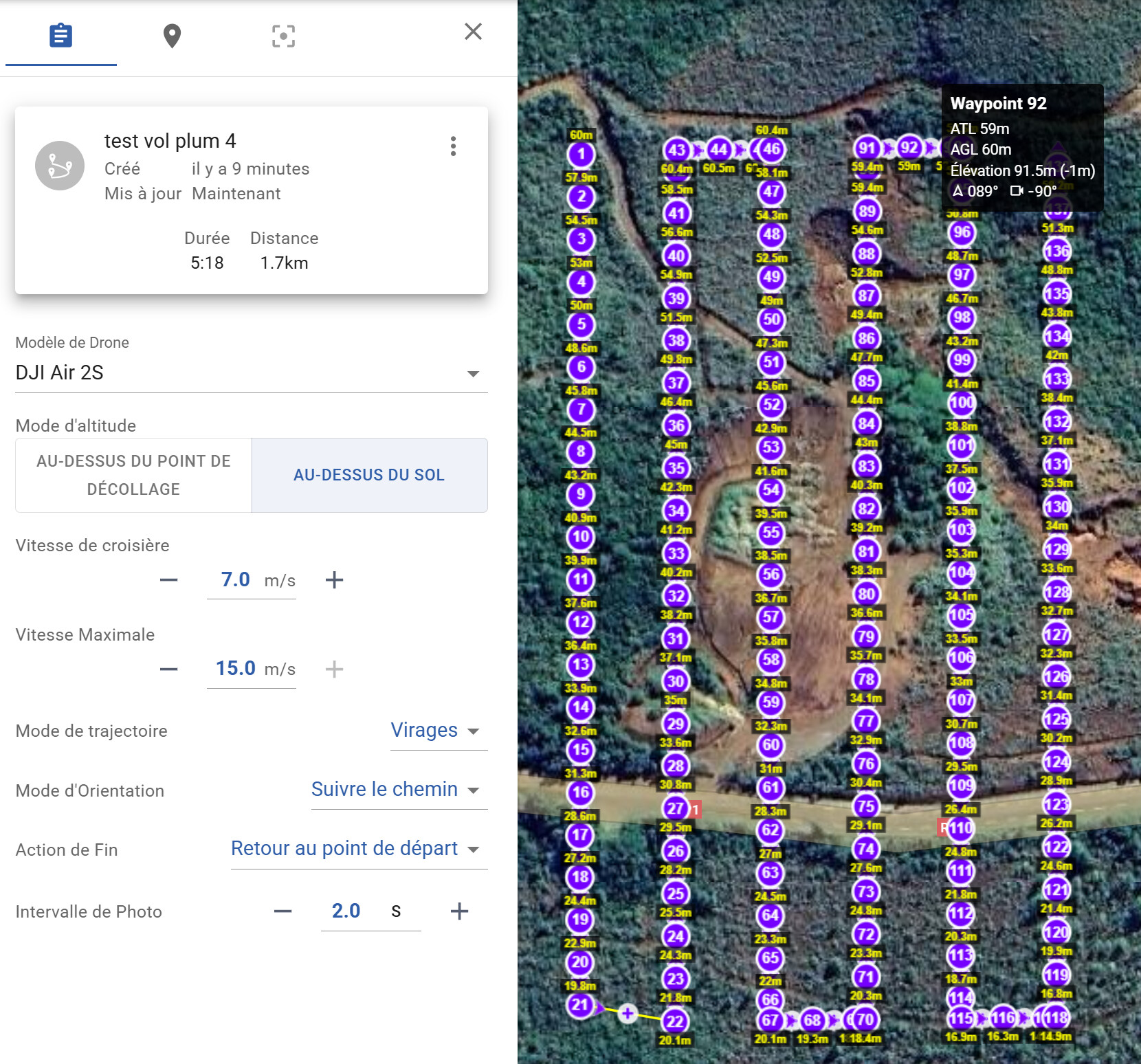

Yes, that is absolutely possible.
Set your ‘Path Mode’ to Curved Turns and you already have the Photo Interval set to 2.0 seconds.
If you are asking about the drone Following Path.. Yes, it will still work.
If you want all of your images to be captured in the same N/S orientation, you can set the Heading Mode to ‘Custom’ and change the waypoint headings to 0° or 180°
