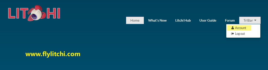

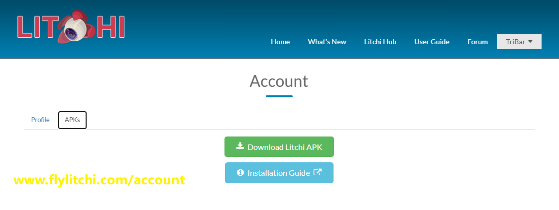

Download the APK from your Litchi account page:
(As @vico posted in the post you replied to in your duplicate post:)
