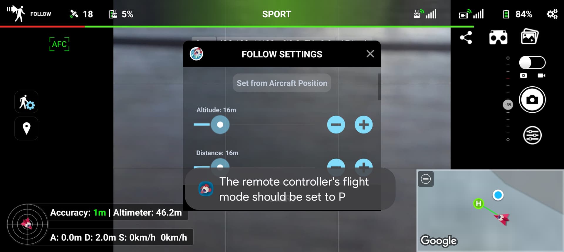

Wenn I try to activate Sport Mode in a follow Mode I get the following error Wien staring the Mission.
“The remote controller’s flight Mode should be Set to P” (See also screenshot)
If I try to switch during the Mission. It aborts…
Sport Mode works fine in FPV and is also enabled in the DJI app. I used this also 1 year ago without any Problems. Anyone any idea?

The RC must be in P/Normal mode for Litchi to control the drone. It’s always been that way, and there is no way around that.
Hi,
Thx for the quick reply, might be that it has always been that way but now my drone only flies like 20 km/h. Is there any other setting that I have to change in order to get the mavic pro fly with high speed in the follow mode?

These are the maximum speeds for the Mavic Pro:
Tripod/Cine mode: 1 m/s
Object Avoidance Mode: 10 m/s
Position Mode: 16 m/s
Sport Mode: 18 m/s
So if you turn Off Object Avoidance it should be able to fly faster.
