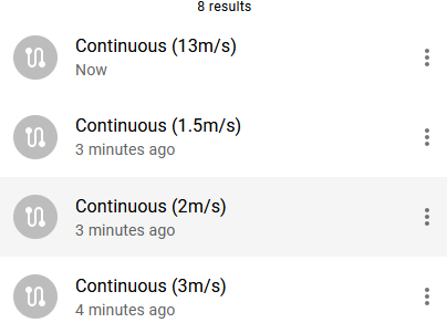

Bug report - flight missions now showing up on the android app
No idea where to report a bug - but the web interface allows the use of the / symbol.
however then they won’t show up in the app on android.
So either ban the / symbol from being used on the web interface or make it accessible to the app.
