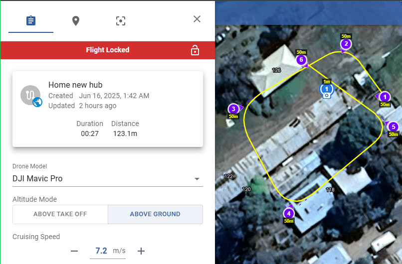

Mission > Share > Set to public and send us the url
Set mission to public. Now how to send URL? Litchi Hub. perhaps
I can’t see anything wrong with the mission you shared.
You updated it 2 hours ago, what did you change ?
I think the only change would be making it public. But I have had the same ‘no go’ result with previous Beta missions.
