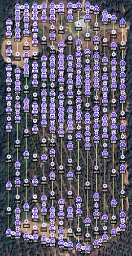

It was (and still is) possible to delete those intermediate waypoints in the Litchi Hub and use Photo Capture Interval (either by Time or by Distance) instead of using Waypoint Actions.

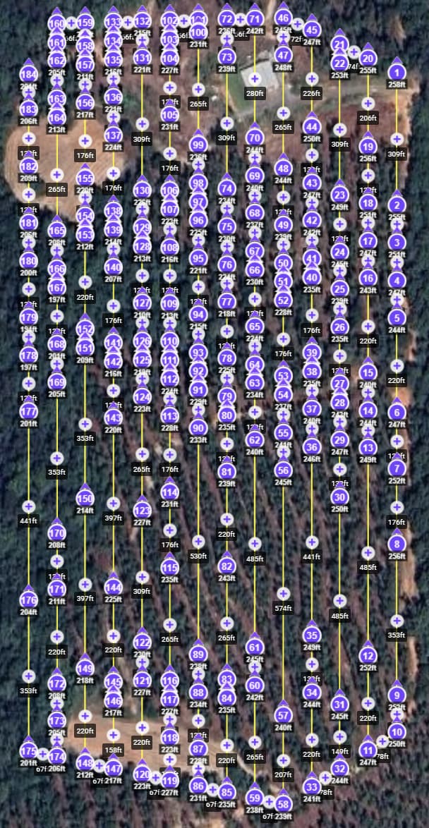

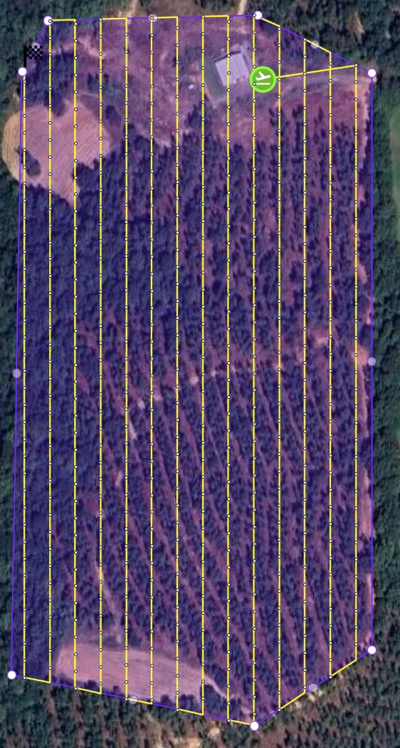

Here is a mission created in Hub Beta, and a screenshot of that same mission in the original Mission Hub. Note: This mission was created using Above Take Off

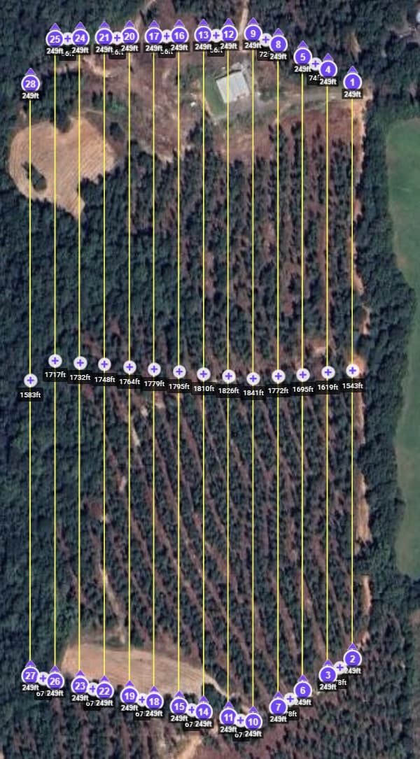

If you use Above Ground to create the mission, it will create intermediate waypoints, because of elevation changes. The same mission will now look like this:
It’s also worth noting that the drone will not necessarily stop at each intermediate waypoint.
With Litchi Pilot (not supported with old apps), the drone will only stop at a waypoint if the 2 segments are not aligned. In the current Litchi Pilot build (526), we consider segments to be aligned if their directions differ by no more than 1 degree. In the next build, this threshold will increase to 5 degrees, so the drone should pass most waypoints without stopping unless there is a significant change in elevation.
