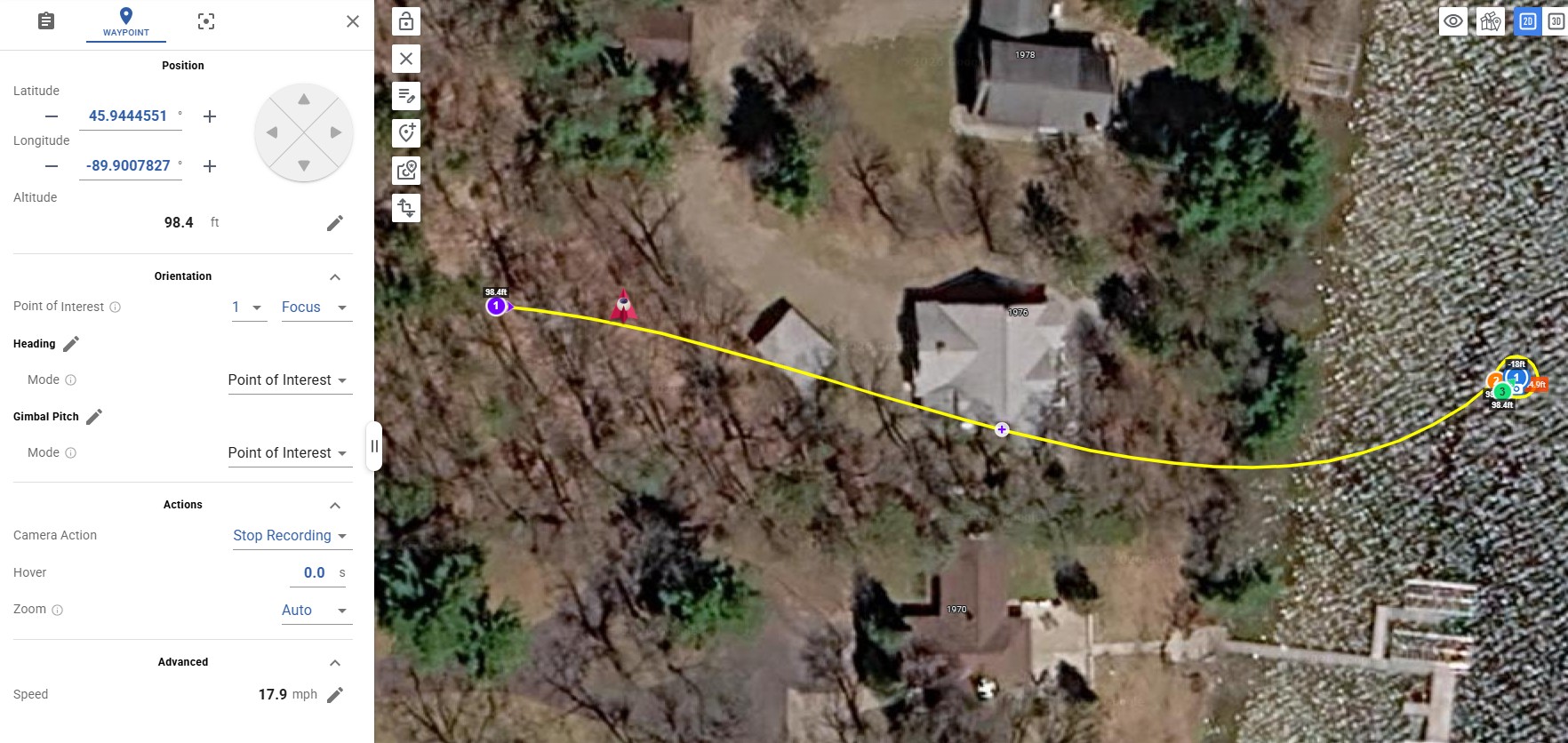

Could something like this work? It’s a very tight orbit (which is what I I use to pan), speed at 1, start recording at POI 2, stop recording at POI 3.
It should work but a couple points of clarification:
  1. One doesn’t start or stop recording at a POI. Instead, you start or stop recording at a waypoint. I’m guessing that is what you meant.
  2. In order for a panning drone to capture usable video footage, the panning speed must be extremely slow. I think you will find this difficult to do. If you do get usable footage, let us know.
Very true. For example, if you travel a circle of 6 ft diameter at 0.2 mph, it will take 64 seconds.
If you travel much faster, the video will be a constant blur
