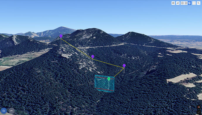

Set your first waypoint near your takeoff point and assign it an altitude.
Then, plot your subsequent waypoints along your path with the desired altitude.
The following waypoints should follow the terrain elevation while still maintaining the target altitude above ground.
Here’s an example of a flight taking off from a mountain:
