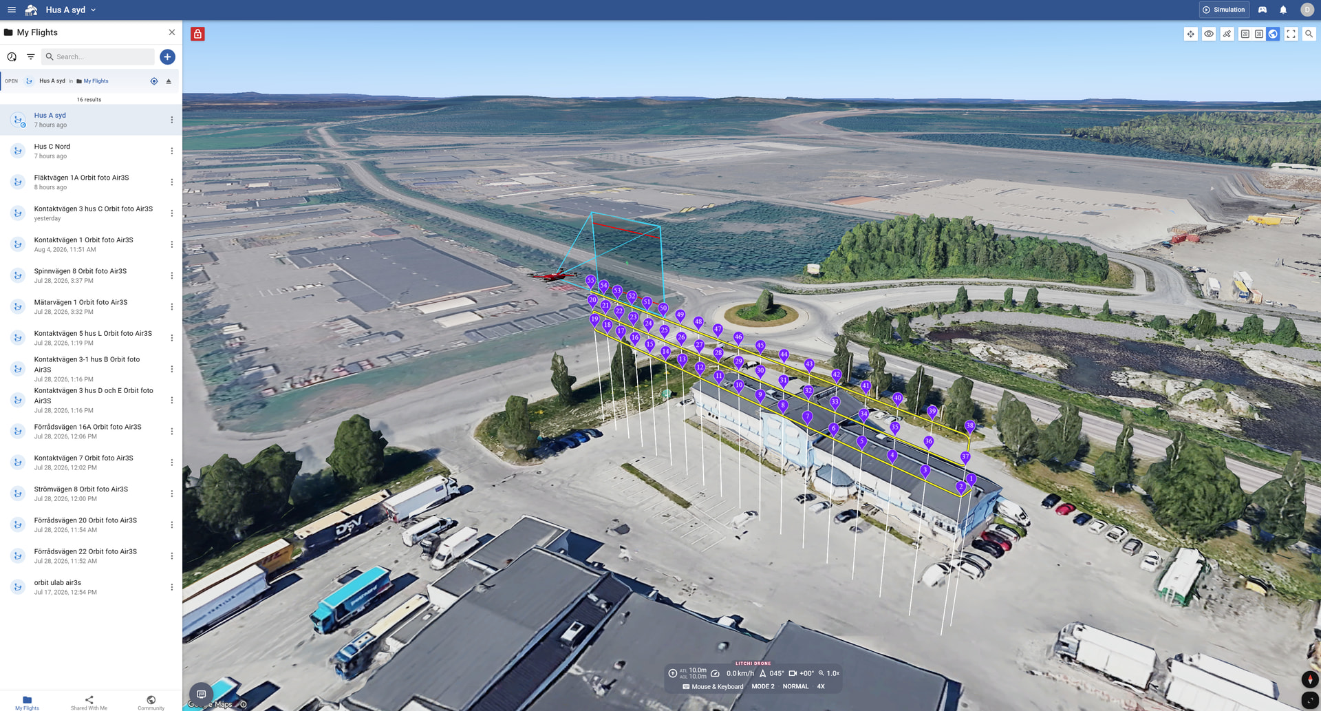

When I create a facade photography mission with Wes Barris’ “Facade Mission Creator” I get a strange preview regarding waypoints. It looks like all waypoints are placed at least 10 meters higher than the selected values, which makes it difficult to make a fair assessment of how the mission is being performed. The mission is being performed correctly despite the incorrect preview. Wes Barris has tested in other locations than Sweden and it seems like it only works well in the majority of other geographical locations he tested. Does anyone have an idea why this problem apparently only occurs over Sweden?

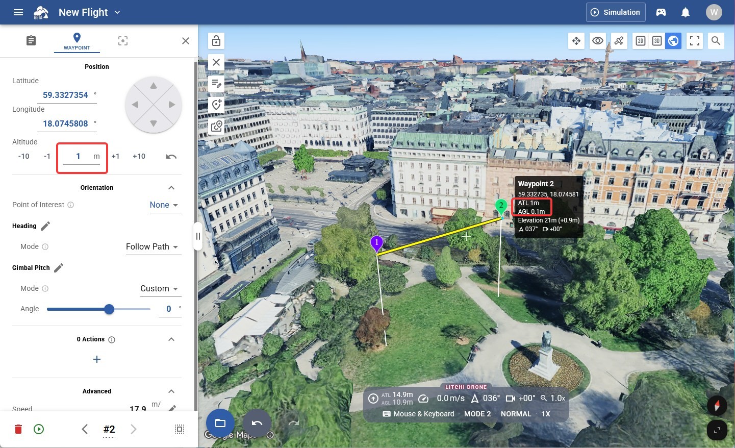

There does appear to be an elevation issue with the Google Earth view but it only seems to occur in Sweden. Here is a snapshot of the Mission Hub showing a 2-waypoint mission in Stockholm where the height of each waypoint is 1m. The Google Earth view displays a mission that is obviously more than 1m above the ground. It is as if the terrain in Sweden is rendered too low in Google Earth.
