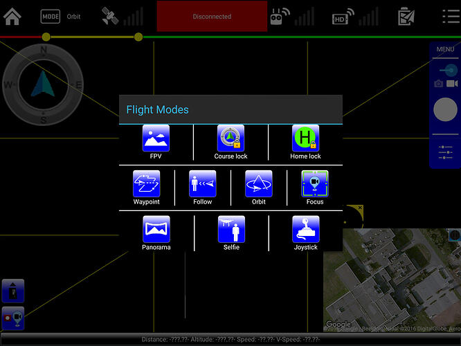

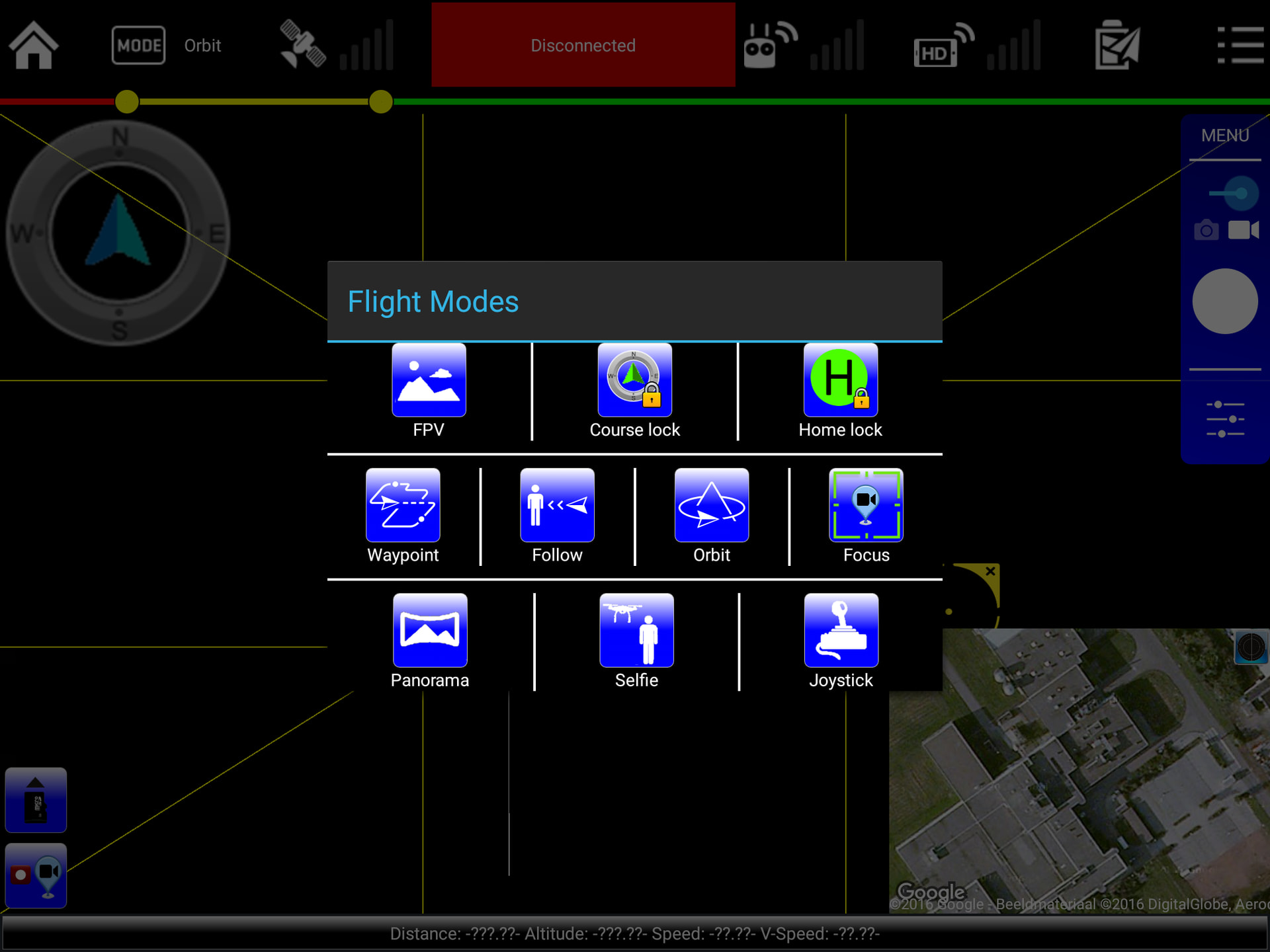

DJI Ultimate Flight was an app developed by Kenneth Argo, a South African guy. The last update/version of the app was v4.0252 using SDK v4.10 dd oct. 2019. No ties to Litchi. He just stopt the development due to other priorities.
I’ve been using DJI Ultimate Flight and Litchi for almost 2 years simultaneously.
