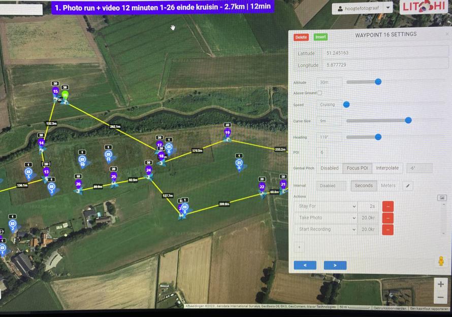

  1. After waypoint 17 the mission is no more doing actions, what can be the reason?
  2. (check printscreen): Is 'Stay for 2 sec + Take Photo + Start recording a good order or is that maybe the issue of my problem?
  3. What does 20.0kr what does that mean? (checkbox printscreen)
Thanks in advance

The only thing I see different in the Waypoints just happens to be at #17.
For some reason (and I am not positive it will cause your problem) you have ‘Gimbal Pitch’ set to ‘Disabled’
All other Waypoints have it set to Focus POI.
That’s just a glitch in the mission hub.
