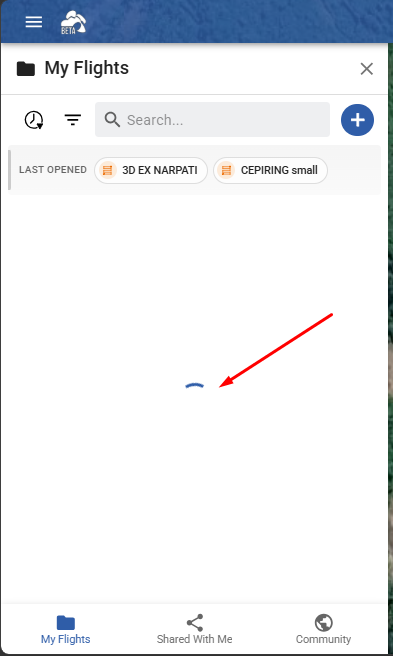

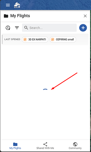

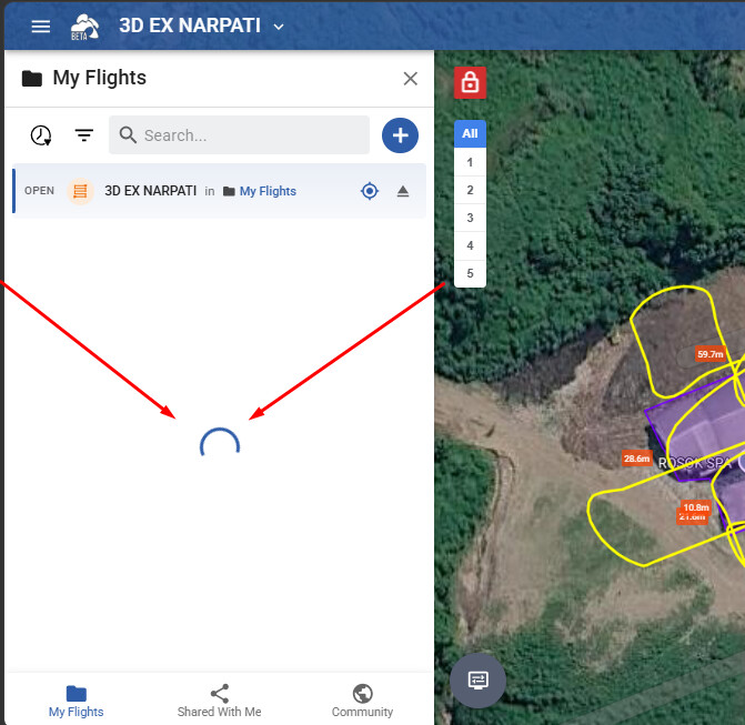

Why My Flights can't load in Litchi Hub? It's always loading
Log out and log back in
I’ve tried to do it, I’ve even deleted the cookies in the browser, but it’s still the same, I’m using MS Edge 149.0.4022.69 (Official build) (64-bit)
Have you logged out of the Mission Hub and logged back in.
Yes, I have tried logging out of Mission Hub and logging back in, but it did not make any difference. The issue still persists.

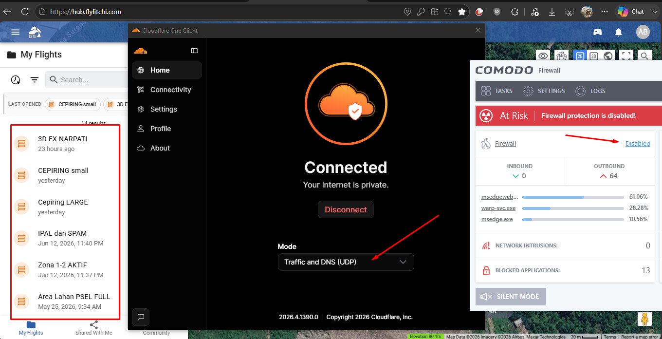

I can finally display My Flights. I did the following:
  1. Disabled the firewall
  2. Tried using Cloudflare One Client using Traffic and DNS (UDP) Mode
Thanks for your suggestions.
