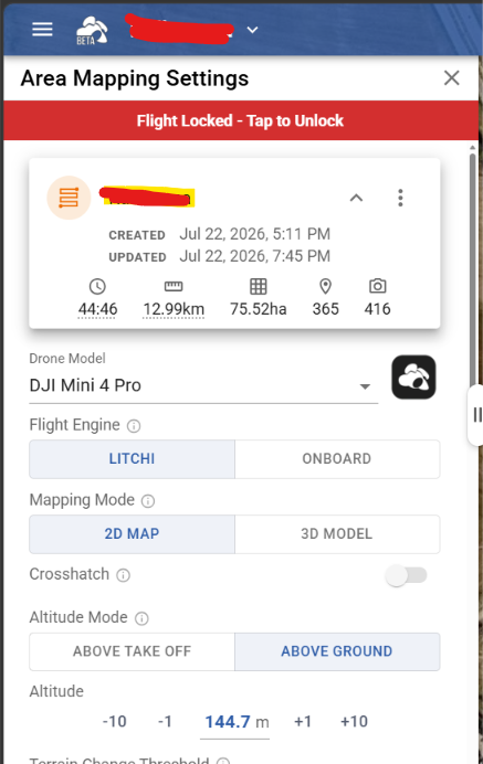

Hello,
I am not sure why the waypoint counts and images do not match, is there any explanation, I google it couldn’t find a good answer.
Is it fine, any explanation for the discrepancy?

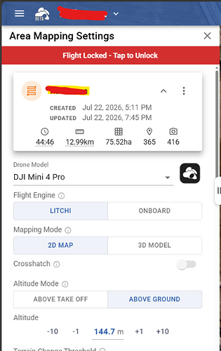

Hello,
That’s normal if the Photo Capture Mode is set to Interval (or Auto for some drone models like Mini 4 Pro). The drone will take photos in between waypoints too.
