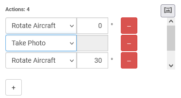

You will not need to pay anyone. You can do this yourself using the Mission Hub. At a waypoint you can add “Actions” as shown below:
Add as many as you wish by selecting the “+” sign and selecting which action you would like to add.
When you have more questions, come back here and ask.
