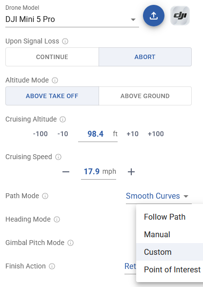

The old app has always been like this, Custom without a linked POI is a transition, Custom with linked POI = POI. We will rename the mode to Custom/POI.

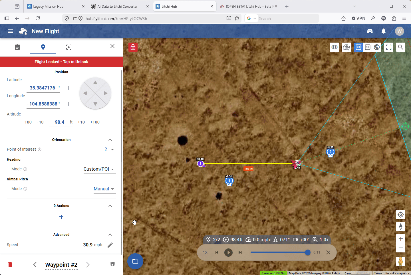

POI/Heading Bug Report
Issue: When simulating a mission that contains multiple waypoints and POIs, the drone’s heading always progresses in the clockwise/positive direction as it transitions from one waypoint/POI combination to the next waypoint/POI combination.
Expected behavior: During a simulation, as the drone transitions from one waypoint/POI combination to the next waypoint/POI combination, the drone’s heading should always interpolate in the shorter of the two possible rotational directions as the drone actually does when flying the mission.
Here is a simple mission that demonstrates the error. Click on “Simulation”. Note that this is most easily observed in the normal 2D view.
Curiously, if the Mini 5 Pro drone is selected, the simulation is displayed properly.
I could not reproduce the issue using your flight, when I run the sim, it rotates counter clockwise as you would expect.
yep it rotates anticlockwise here as well :+1:
Yes, it is working for me today too. Yesterday I was working on a larger mission and I know what I saw. I was also able to recreate the problem with that smaller mission too. I tried changing a number of things. It wasn’t until I changed to a Mini 5 Pro drone that the rotations began to occur in the expected direction. I’ll have to do more testing to see if I can repeat it again.
I am able to reproduce the problem I described yesterday. Evidently, the act of sharing the mission eliminates the problem. Also, if I re-open the mission, the problem is eliminated. So, here are the steps to reproduce the problem and a screen recording:
  1. Click “+” sign to create a new mission.
  2. New Flight → Waypoint → Drone Model: DJI Mavic 2 Zoom → Create.
  3. Select Mission Properties and set Heading Mode to Custom/POI.
  4. Place two waypoints, one to the left, and one to the right as I did for my demo.
  5. Place two POIs, one at a 100 degree heading from WP1, and one at an 80 degree heading from WP2.
  6. Select WP 2 and set the Point of Interest to POI2.
  7. Click on “Simulation”.
  8. Notice the heading progresses in the wrong direction.
Since I cannot demonstrate this with a shared mission, I made a screen recording:
Capture

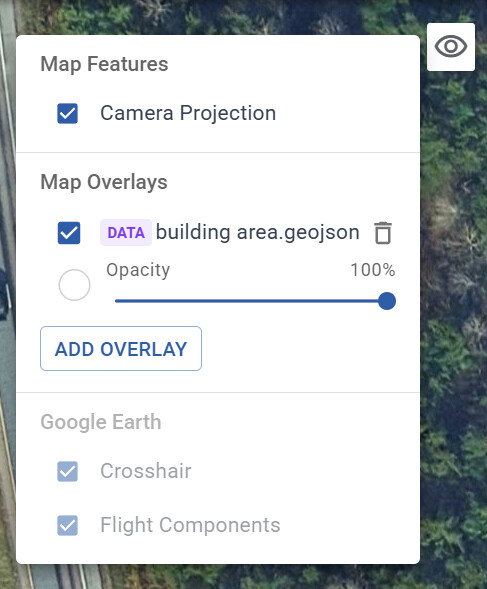

Thank you for the suggestion! You can now import GeoJSON files as overlays, as well as GeoTiff orthophotos and DEMs
I just tested this. Very cool! However, now that a GeoJSON has been imported, I don’t see a way of removing it.
Click the delete button next to the overlay name in the map overlays list:

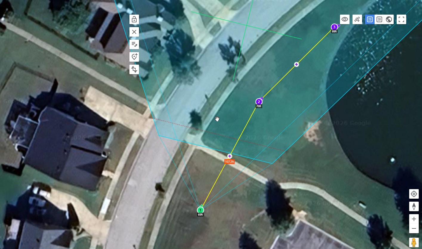

I have the same thing happening. Do you think the drone will really make this turn in real ?
