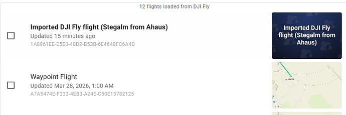

HI. I’m using a Mini 5 Pro and RC2. Followed the tutorial(s) on how to use the Litchi Hub and created a new test waypoint mission at https://hub.flylitchi.com. Once I had simulated the flight to check it was right I clicked on the “DJI“ icon to upload it to my controller. The bridge was working and the controller connected and recognized. The upload seemed fine so (after first creating a dummy waypoint mission) I could see the newly uploaded mission. I copied the dummy mission’s name and then renamed it to something else. Then I renamed the Litchi generated mission to the dummy missions file name. This all seemed to go without error.
Back at the controller I chose “waypoints“ and expanded the missions. I selected the new mission but it only shows 2 waypoints where it should show 9.
I’m not sure if this would change with the mini 5 pro actually connected to the controller or whether I have done something wrong here that has failed to upload the actual new mission.
Any assistance is very welcome.

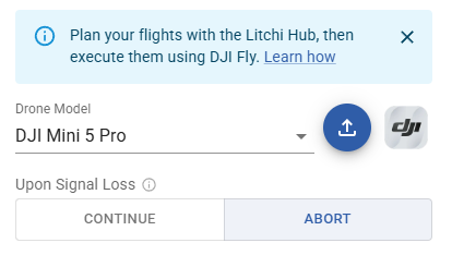

Looks like your dummy mission (created on the RC 2) was NOT overwritten.
After creating the dummy mission on the RC 2, go back to the Home screen of the RC 2, then press the “Upload” icon in the Hub (the “DJI” icon doesn’t do anything when the Mini 5 Pro is selected as drone model).
Then try again without all the renaming stuf.
(You rename an overwritten flight on the RC 2 itself)
Thanks very much for your help. After some initial confusion I have now uploaded the planned test mission and it shows the correct number of waypoints. Very much appreciate your help with this. :folded_hands: :+1:
