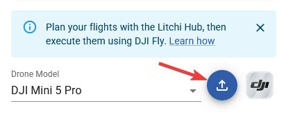

  4. In a browser, load the new Litchi Mission Hub and open a mission designed for your drone (Mini 5 Pro, Air 3S, etc.)
  5. Select the export/import button.
  6. The “smart export” window should open and show any flights on your RC2 controller.
