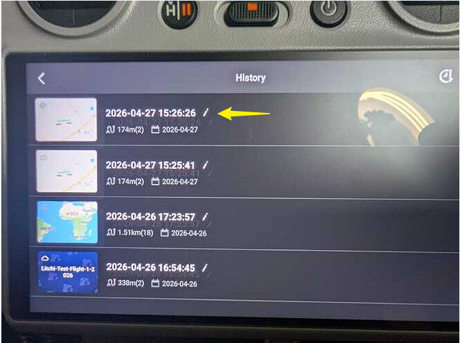

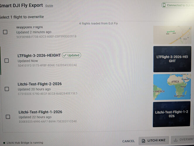

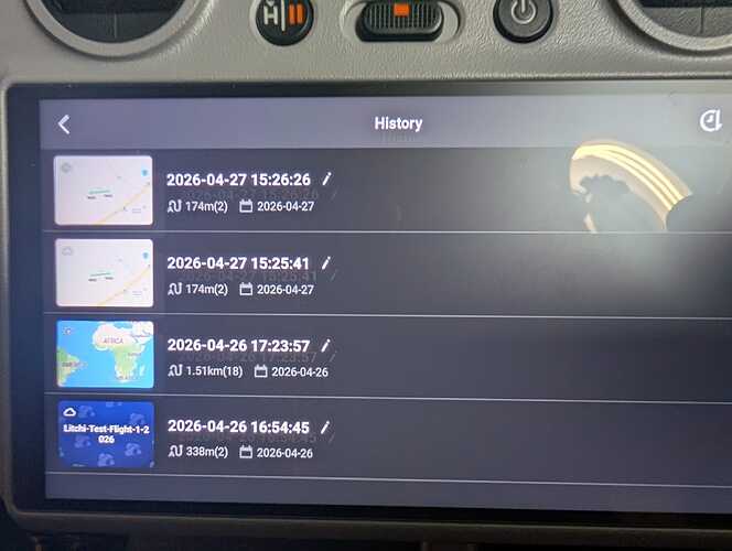

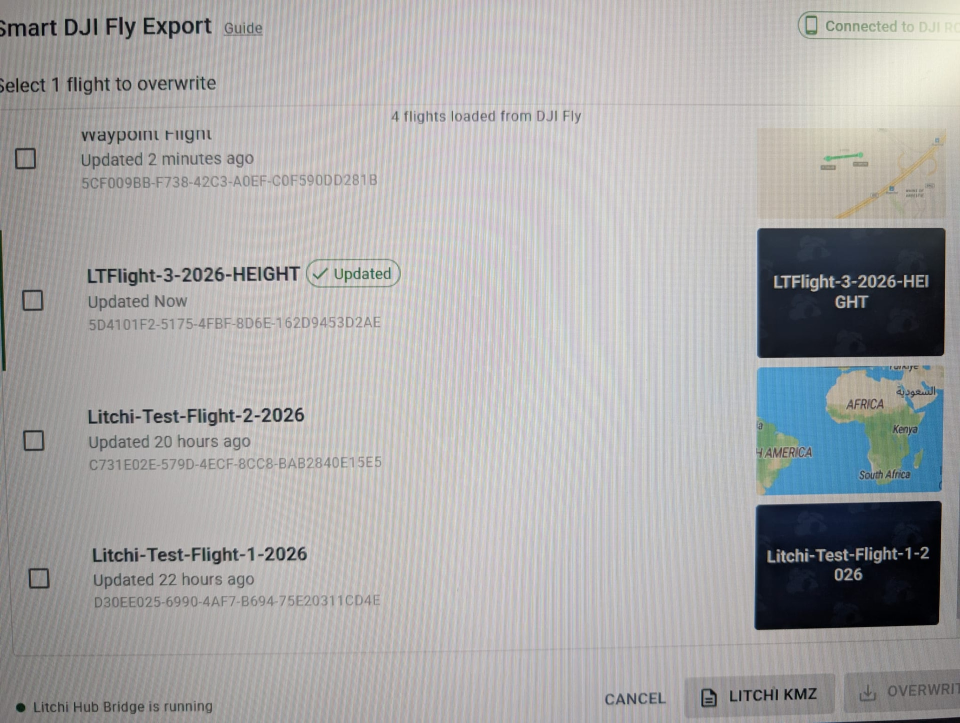

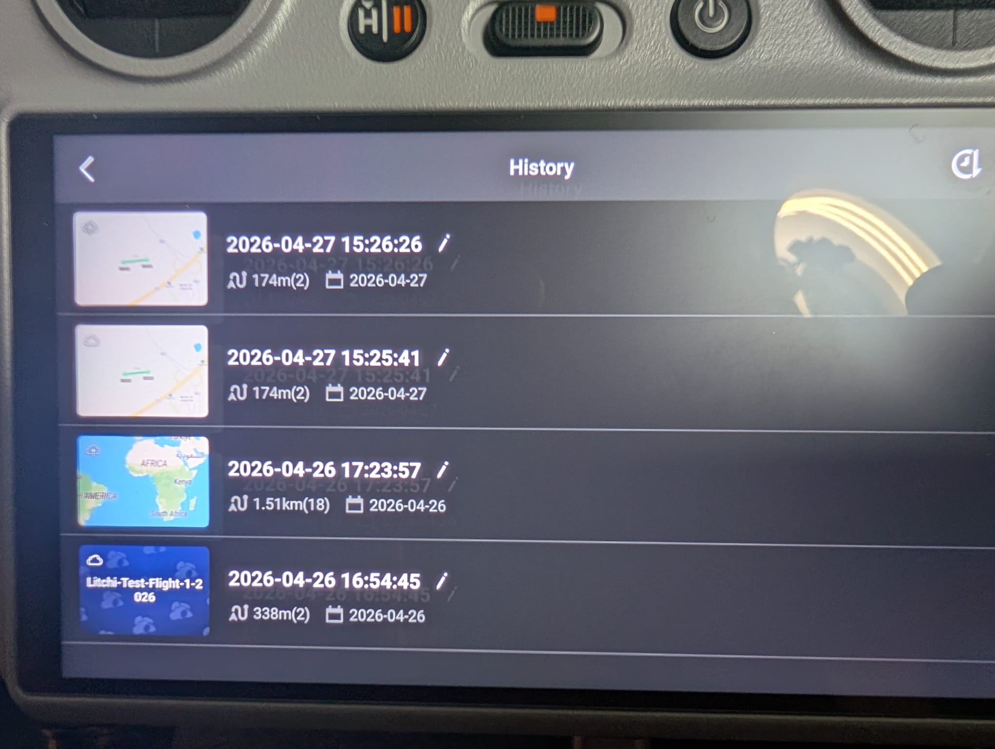

Here are a couple of screenshots to show the various (wrong) thumbnails and missing titles.
On the RC 2 (or better: in DJI Fly):
-Every time you open a mission, then exit with “Save and Exit”, a new thumbnail is created using a screen dump from the current/last view.
-You rename a mission by clicking the pencil icon right next the mission name.
I’ll give this a try, thanks. I had tried using the pencil next to the name but couldn’t get it to work for some reason, I was also confused why the original test mission brought over the name and the thumbnail during the export and I didn’t need to mess with changing the name etc, myself.

Follow step 2 in the guide to the letter (dummy creation), then the Litchi preview image will transfer correctly: [GUIDE] How to use Litchi Hub with DJI Fly / SkyRover
DJI Fly has a cache for preview images, once it caches its image (upon loading the flight in DJI Fly), it’s impossible for Litchi to change it. Name and date do not transfer on android.

There’s definitely something weird about this process, because last night I spent time renaming the flights (on the controller) to what I wanted and then saved each as I did it. Went out this morning to test two new missions and the names in the mission list (on the RC2) have lost all the work I did on naming yesterday and reverted to the original auto-generated names for two of them, but left the other two untouched (only one of those shows the Litchi Thumbnail).
There’s probably something in my method that is throwing it off, I will go review the tutorials again and see if I can see what I am getting wrong.
