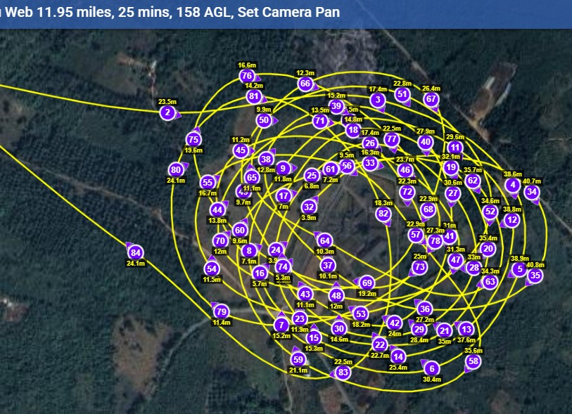

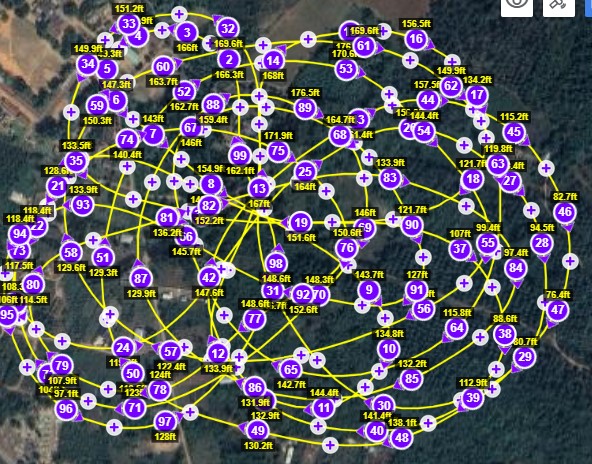

To test the precision of the waypoint mission transcription process from Litchi Mission Hub to DJI Fly using the Hub Bridge, I created a convoluted spider’s web-shaped waypoint mission that took the drone 27 minutes, flown at 26.8 mph, to cover the total 11-mile distance, after launching the Air 3 with 100% battery, then landing it after the 27-minute journey with 20% battery.
While the shape of the flight path and the fixed 180-foot altitude made it through the translation process unchanged, I did notice at the start of two separate test flights of the same mission, that the global mission speed that I set at 29 mph had been unexpectedly altered following the translation process, from the specified 29 mph, down to 5.6 mph, which apparently is the Air 3’s “default” speed unless otherwise specified.

Not long after daybreak I launched my trusty Air 3 on a 12-mile round-trip waypoint mission that was created on Litchi Mission Hub without the inclusion of any POI’s and with the camera gimbal pan (yaw) and tilt set to 'manual".
The spider’s web flight path, comprising 85 waypoints flown at 158 feet AGL and 26.8mph, took the drone 26 minutes to complete, before the drone’s landing within two inches of it’s launch spot, and with a surprising 29% of battery power left.

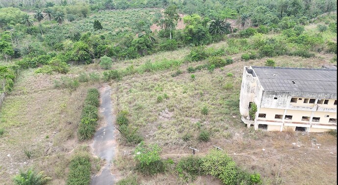

This flight was partly to test the Litchi Mission Hub Bridge, but also to record the capers of a few outlaws that have been stripping the metal fixtures from an abandoned hospital located about a mile from my lair. My friends in the regional vigilante force are always eager to engage in a little plinking practice, and the last time I alerted them to the presence of the looters who accessed the hospital grounds via a gaping hole they broke in the perimeter wall, events took a turn for the worse, from the burglar’s perspective.
Here a couple of the scrap metal prospectors can be seen spiriting away their haul for the day, evidently without a care in the world about previous skirmishes that occurred there.

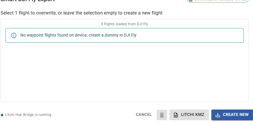

After several successful waypoint mission overwrites from the new Litchi Mission Hub on my laptop to DJI Fly in my iPad, I am now unable to overwrite a newly created Litchi Mission Hub waypoint mission into DJI Fly. Nothing has changed in the steps I used, which makes this error message all the more baffling.
The error message claims that I have NO waypoint files in DJI Fly, despite my having over a dozen of them, with several more that I created as overwrite templates.
There is clearly communication between the iPad and the laptop, so I cannot figure out why this overwrite process that worked just fine yesterday, suddenly stopped working today. Also I did remember to click on the Litchi Mission Hub Bridge icon before attempting the waypoint mission overwrite.
Exasperated, I decided to try to copy the waypoint file into my Samsung tablet instead, but that didn’t work at all, as has been the case all along. I went back to trying the overwrite process with the iPad after switching it off and back on, and switching the laptop off and back on as well, but the problem persists.
Any advice that can be offered as to how I can get this process working again at least for the iPad, would be appreciated. I was having some great adventures with my Air 3 before this issue cropped up, and I am at a loss as to why the file overwrite worked perfectly yesterday, yet would not work at all today, even though my procedure remained unchanged.
What does it say in the upper right corner of your screen shot?
It looks like you somehow deleted all waypoint flights on your iPad,
Can you access existing waypoint flights directly on you iPad or the History list empty?
In the upper right there is a small banner confirming that the iPad is connected. All my waypoint flights are intact and not deleted in DJI Fly, so the message telling me they don’t exist is confusing.
Yes, I can also access the waypoint flights I copied from Litchi Mission Hub yesterday and the day before. They are all present and functional, yet the error message is telling me that they don’t exist.
I would say there is a communication error between your iPad and computer.

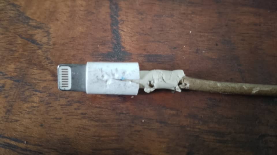

I also suspect the cable. The market is flooded with counterfeit Apple Lightning cables, and the only genuine one I have was chewed on a while back by one of my hounds, but has worked fine despite it’s tattered appearance, until now. I think this is the issue, and now I have to try and find a genuine Apple cable that will replace the one I’d relied on until today.
A picture is worth a thousand words.
I tossed it out when I saw the damage, but when the 3 different “genuine” Apple cables I bought locally to replace it all turned out to be counterfeit, I retrieved it and found it useable, until today, that is.
One of the downsides of living in a Third World backwater is that even if one is prepared to pay a premium for genuine products, the likelihood of being sold a cheap imitation is high.

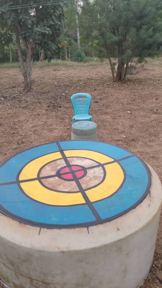

The drone completed the flight and auto-landed barely two inches from its launch point at the center of an overturned 5-foot-diameter plastic tank that I painted like a giant rifle target to improve the positioning cameras’ precision. Everything went flawlessly, proving that the previously imported waypoint mission data is unchanged.
I am hoping this problem is caused by the cable finally losing a vital internal connection after 2 years of regular use in that chewed-up condition, yet the error message which incorrectly states that I have no saved flight plans in DJI Fly, and should create a dummy waypoint file, suggests that DJI Fly on the iPad is communicating with Litchi Mission Hub in my laptop, via the Hub Bridge. This hints at a possibility that the cable might not be the culprit.
